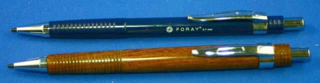

While in Office Depot for my yearly Turbo Tax fix I was looking at the pen isle for ideas. I found a card of pencils by Foray. Three for $3.99. I tossed them on my shop desk and tonight I played with them. This pencil can be made using the pentel step bit...with a little modification. I'll have more time on Wednesday evening to give all of the details, but until then, be thinking about it. The pencil has no number but on the back of the pckg under the bar code is Item 758-742 and the Office Depot number printed on the receipt is 735854180904. They may be available from other stores. Until Wed evening, here are a couple of pictures.

For curiosity's sake, I picked up a pack of these whan I went to office depot today. I picked up the 0.7 mm, but I did see they had 0.5 mm as well.
The mechanism feels very different, its feels smooth but without a distinct click as is present in the real pentel. The mechanism also advances the lead about twice as far each time you press the button.
The black tip on the OD pencil is spring-loaded and pushes into the nib if you press on it. I guess this is to support the lead so you can write longer between extending the lead. The black tip is also tapered, so not suitable for using it for drafting or template work.
I like that the pack comes with 6 extra eraser refills, but the erasers provided fit very loosely into the end of the pencil and do not protrude very much. I think the one longer, adjustable eraser that comes with the pentel would be able to erase just as much as the OD eraser refilled multiple times and is much less likely to be lost.
The stock barrel is slightly wider than the pentel, but the thickness of the barrel at the nib seems to be just as thin, if not thinner, than the pentel (I see this as the most likely place for it to break).
Precision drilling will be required, just as with the pentel, as the step to stop the mechanism protruding at the tip is only about 1/10 of an inch from the nib end of the barrel. This step is quite a bit smaller than on the real pentel as well, so off-center drilling would significantly affect the assembly.

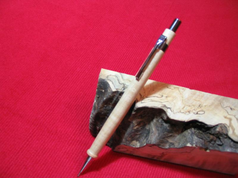

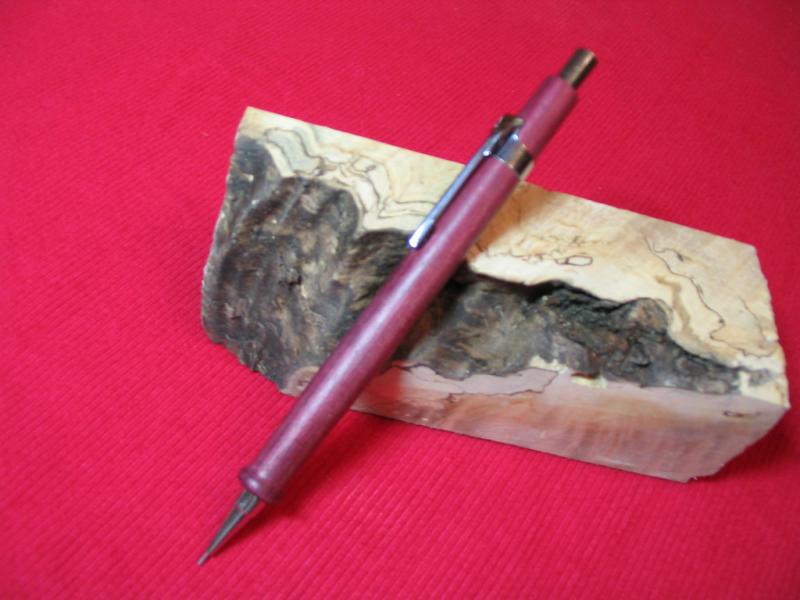

Yes, thanks Jason for the review. You beat me to it. But I have now made #2 and #3. I had a problem with one of them but the other one is fine, as is the first one. I've also finished a photo essay of how I used the step bit several of the IAP members purchased for making the Pentel pencil to make this pencil. It can be found on my website at http://tinyurl.com/2eaxy4 Here is a picture another one of these pencils.

Thanks for taking the time to do that. Those pencils will make excellent gifts.
Thanks to all for the comments. I hope the essay helps. I think the pentel can be made the same way, just omit the steps where the blank is turned around and the small hole is enlarged. I've really have good luck turning the pencils between centers. I did not have such luck when I first started making the pentels. Maybe my turning skills have improved.
