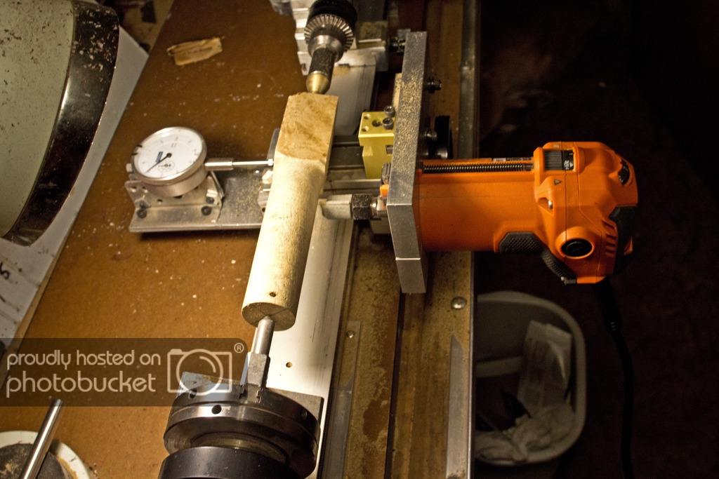

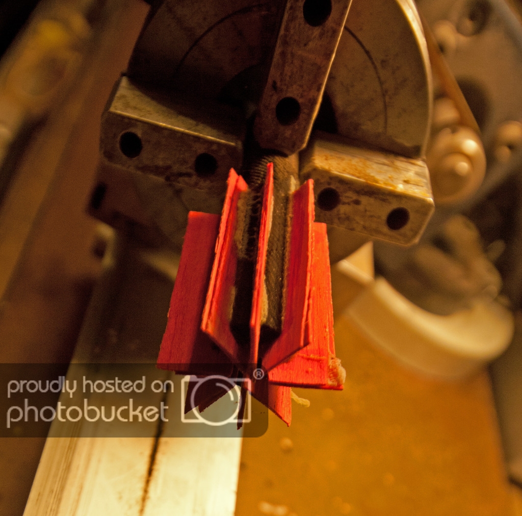

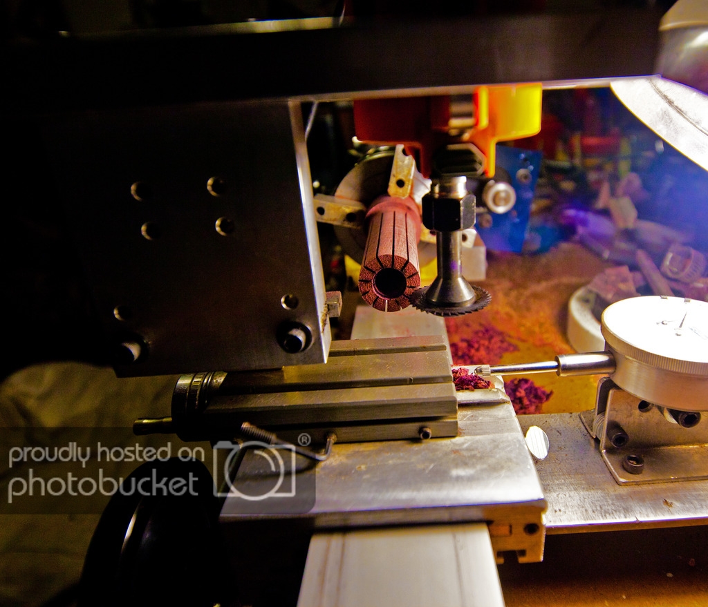

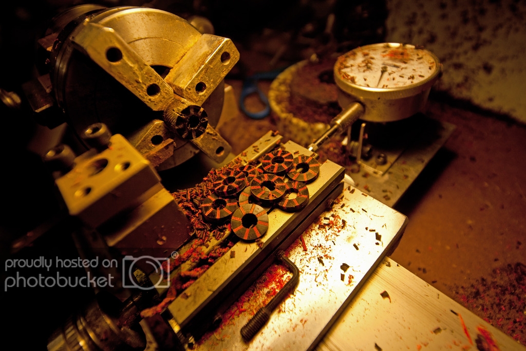

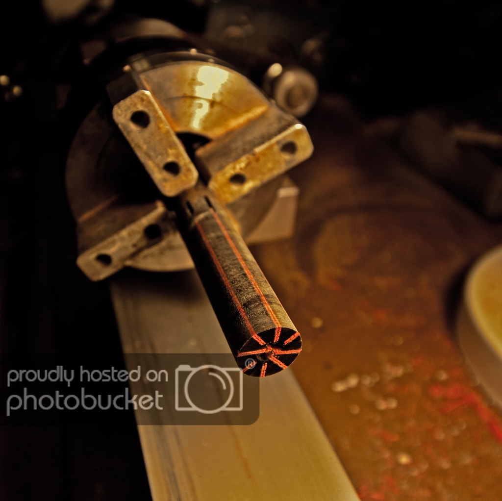

All of the big lathes are covered in oil , you cant go into the machine shop without getting oil on you some where .
You cant tough any of the tools .
Machine shop is worthless for wood .....
In my wood shop I now have 4 lathes 3 of them are like this except with live cutters mounted on the tool post.
Large bore headstock
