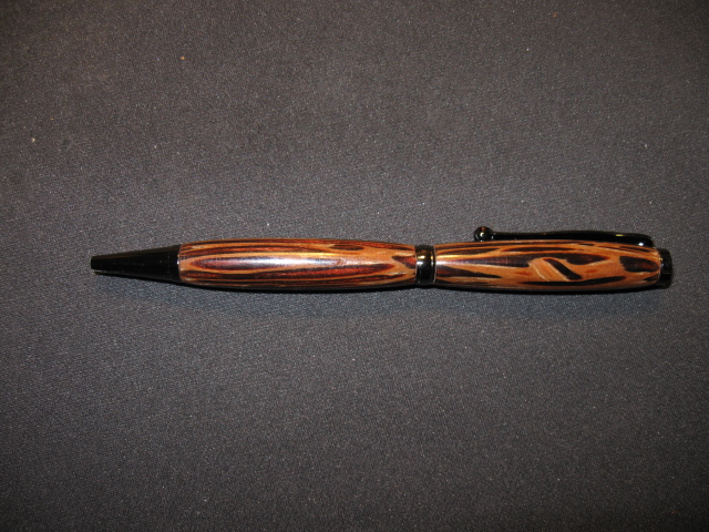

The attached pic shows the one and only time I tried black palm. As stated, it is difficult to work with, and seems to need constant restabilization. I have to put this wood with Wenge as some of the most difficult woods to work with, IMHO.

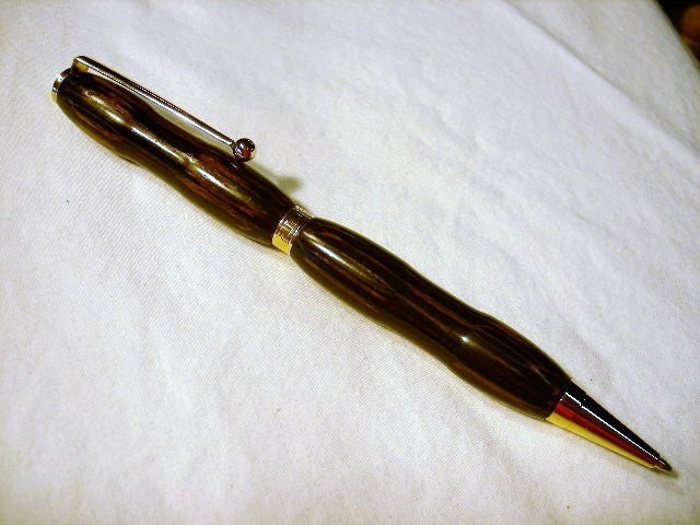

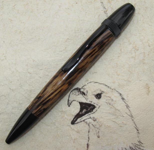

I use lots of thin CA and always round it off on a sander before turning and have turned quite a few from it.
