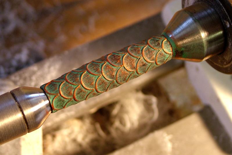

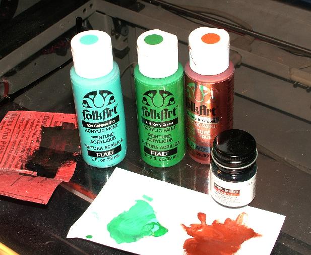

Trying to get a decent aged copper effect. Seems like it's missing something.
Maybe I should actually LOOK at some aged copper.. :tongue:

You guys appear to really be onto something. Its amazing how you took a piece of equipment that's been used for quite a while in the pen world and transformed the output into something very original. You continue to impress and its only the start.
Well I'm glad that you know what the hell is going on Bruce!!!I not only can't figure out how they were made, but I'm really stumped as to why they are even mounted in a lathe!!!:redface:

NL- i may have skipped over it, but is that actual copper? if it is, look at stained glass craft suppliers.
Don't be stingy with the CA and the paper towel will work. Drops willl not work well. I am using a stream of Medium. Go easy and wait 4 or 5 goooood coats before you get aggressive. I am applying the CA on the slowest speed and letting the CA spin for a bit before I use accelerator. Use considerably more CA than normal, because these blanks are not normal- just unique. I printed out the address labels so sit by your mailbox testers. Coming soon to your neighborhood.
Maybe i will break out the ole airbrush! I bet an airbrushed CA finish might be pretty cool! hmmmm... Sure am glad my airbrush is external mix!
