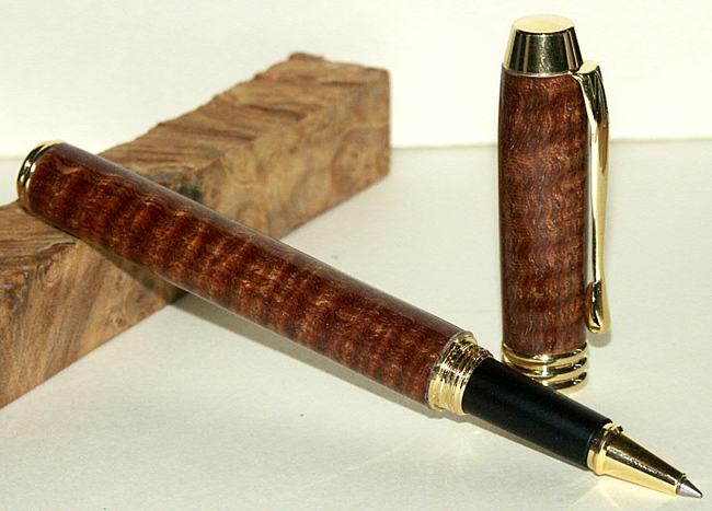

Here are two more pens from wood I got from Bill at Arizona Silhouette... both are 10K Executive Roller Ball kits that CSU sells.. I really like these kits and they are easy to convert to fountain pens.. just change the point sections... my customers like them too... they sell well for me... a nice size pen for both men and women to write with... ~ both photos are a bit darker than the actual pen
Curly Caramel Maple
Finish is BLO sanded in at 400grit, then CA and MM to 12000, followed by TSW and Renaissance Wax

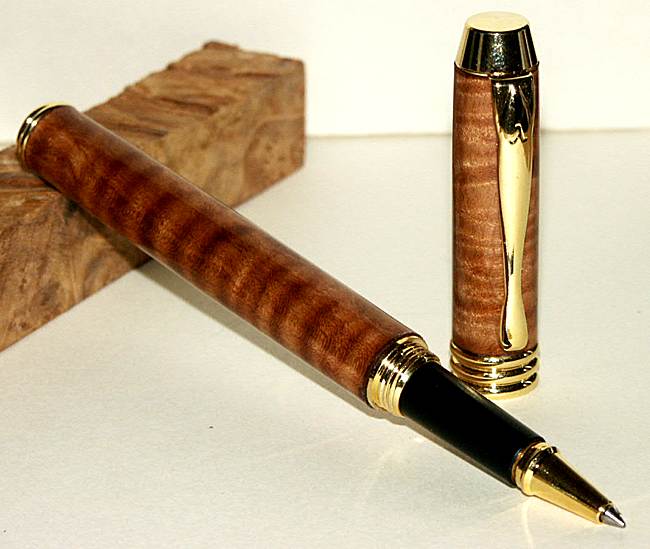

Stabilized Curly Honduras Mahogany (one of the freebies I got from him)
Finish is sand to 400 grit, then CA and MM to 12000, followed by TSW and Renaissance Wax
</u>
TSW first, let it dry on the lathe for about a minute (it will dull a bit so you will know) and then buff at high speed with on old tshirt, then a light coat of Renaissance Wax let dry a minute and buff again with a tshirt at high speed, all on the lathe..
