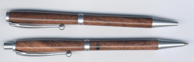

This first is for my BIL, Black walnut with CA/BLO finish. The slimline is a satin finish.

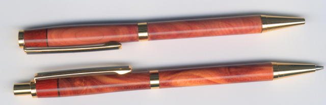

This next set if for my FIL. It is aromatic cedar with a little bit of padauk. This finish is CA/BLO. The reason for the padauk was on the pencil there was some "chunk" out along some growth rings that went too deep, and not wanting to loose this wood, I just turned approx 1/2 of the top off of both and replaced with padauk. The black line between the two woods is ground coffee.

Very nice cedar set Ryan, I like the tips as well, nice contrast. That's a new one on me coffee grounds! At least I don't have to save them, I get 4 batches a day. Very nice work. Anthony
Nice looking pens and some of the best "OPS"ring work I have ever seen.
Normally when I try that trick they look out of place.
Yours have the look of a well thought out design.
Thanks for the compliments everyone. For the coffee grounds I take and grind them up so they are almost dust, then I applied medium CA to the exposed tub and around the cedar. I then sprinkled on the coffee and put the padauk piece on.
I have used coffee grounds to fill in voids and cracks on other pieces, sometimes it turns out like another spalt line (if the piece is spalted to begin with).
