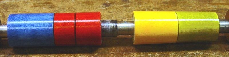

This is my latest attempt. I found out that more dye really helped. I used an eyedropper and flooded these sections with dye. About 1/4 dropper per color. I just kept turning the lathe by hand and applying more dye. The left line on the red-blue one is a small cut with a skew point. That pretty well stop any bleeding. The right line is a wire burn. The yellow turned out much more intense than I had experienced before. The green is yellow and blue dye mixed. Not as green as I wanted. I don't think mixing these analine dyes will give a real intense color, at least I can't get it. I also found out the dye penetrated much deeper than I expected. I had to turn down about 1/16 in to get out of any color. After the dye dried I gently applied mylands sealer and had very little smearing. Buffed that out and applied friction polish. It is not as glassy as I would like but I hope that is because I only went to 280 grit sanding before applying the dye. Oh, yeah- the wood is holly. I was going to turn a holly pen anyway. Anyway, this is my latest experiment.

John, I was applying the dye the same way as you and could not get a good rich color. On the blank above I used an eyedropper and squeezed it out directly on the wood. I turned the lathe by hand and kept on applying more dye. I used a quarter of a dropper full I imagine. I have also found out that holly is not the ideal wood. It is to dense and white. I tried a mixture of blue and red on a piece of curly, spalted maple. It turned out a brown instead of purple but it really looked good on that maple curl.
I also wanted to see if a tiny cut would prevent bleeding and it worked good. You just have to be careful when squeezing the dye out of the dropper.
