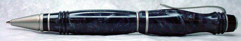

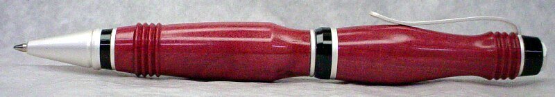

Pink Ivory...my favorite wood:

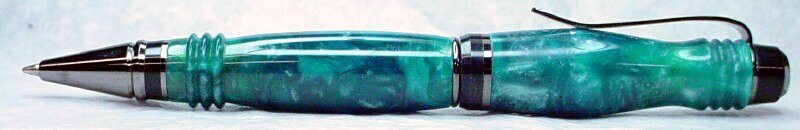

EddPoliResin#7:

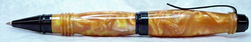

EddPoliResin#8...my favorite so far:
EddPoliResin#9...not enough filler, brass poking through:

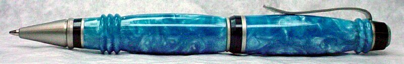

EddPoliResin#10:

I like your colors, Ed. And the pens are very nicely done. Are you using polyester resin? Dyes for PR? Luster Powder(filler)...I have tried some colors(dyes for PR) but not happy with my results. maybe I need more luster powder. Don't like acrylic paint pigment as a colorant (which is what I used first). Thanks for sharing....when is the article going to be published ;-)

Don,
Yes, these are Polyester Resins; and I'm following Jay Pickens' process pretty much as written. The only exceptions are, in some cases I'm mixing in other Douglas & Sturgess "Powdered Pigments†like the "Duochrome BG" (EPR#10) and the "Luster Pigment" called "Supersparkle" (EPR#8). Between the powder pigments and these concentrated liquid dies, there are literally thousands of color and texture combinations that you can come up with. I’m very happy with the process that Jay’s documented...having a ball experimenting with all these variables.
Here's a link to Jay's write-up: http://www.penturners.org/content/PR_Instructions.pdf
