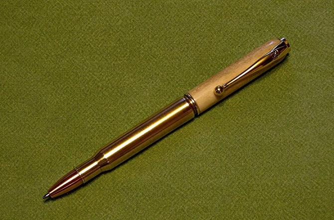

Recently I asked members to help me decipher a good way to do my own cartridges for pens, including the bullet nib. Received several great tips and especially want to thank Sylvanite & rherrell for their assistance and advice. Rick's tutorial was also very helpful. Anyway, I managed to finish a few. The first two were scarffed up quickly by my best friend & my younger son. I managed to get a photo of the third one.
Moose Antler/30-06/Gold Titanium Hardware.
Thanks to all who made it possible
