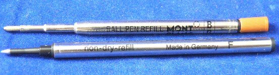

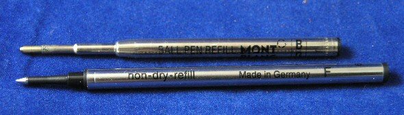

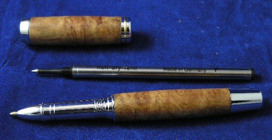

I dont know if this has been posted here or not but I taught myself this last night
Mont Blanc makes the smoothest writing ballpoint pen refills I have every tried.The BROAD is silky for signing your name with.I took my Gent Jr apart and compared the refill with a Mont Blanc ballpoint Broad. I took the cap off a brand new schimdt rollerball refill and cut it to fit the extra needed to make the mont blanc refill.I put the "spacer" I made in he barrel and then inserted the Mont Blanc refill and screwed pen together. WAH LAH ! It now writes as good as it looks. The rollerball refills are nice but this is even better to me. It didnt work on my Statesman though, something blocks it from coming out enough to be usable at the end.
