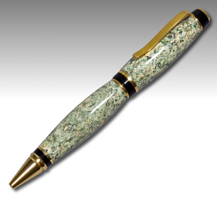

At least that's how I like to think of it. The pen is quite a bit fatter than I usually like, but that's just how it wanted to come out. The material is shredded money -- very densely packed.
Originally posted by fernhills
<br />...did ya get the blank from Eugene...
No, I picked up a bag of shredded money sometime back and have made several money pens and other money items, including a refridgerator magnet, bottle stopper, and goose call. It's a fun material. Regular cast money doesn't have nearly the density of the above pen, and the outcome is more recognizable and less burl-like.
Originally posted by edstreet
<br />ok so who/where has these blanks?
The pen wasn't made from a cast blank. It is actually a glue-up. I packed shredded money around the brass tube and drizzled it with CA glue. I built up the money, turned it to shape, and finished with more CA. It was pretty easy to do - easier than casting anyway.
