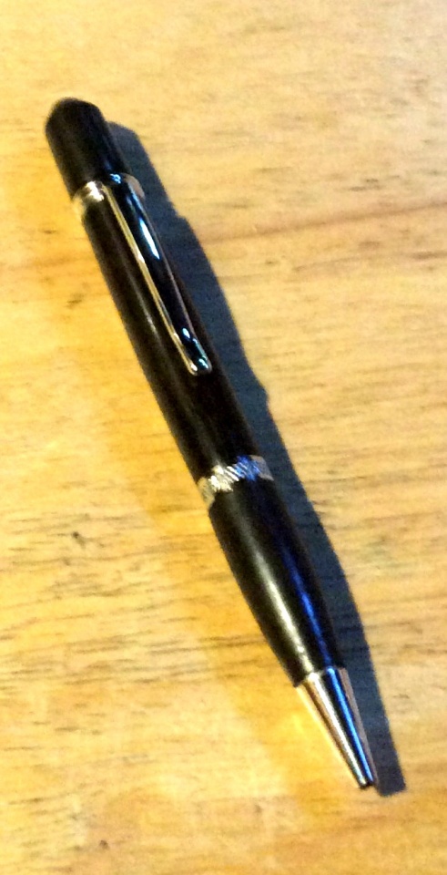

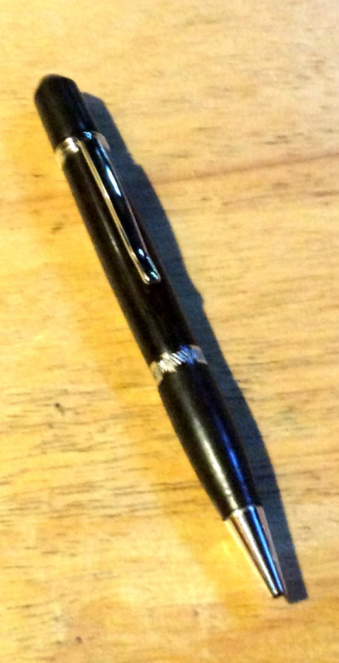

I have a request for a pen that must include three specific elements including a label casting. In order to do this I need to modify a Sierra or a clone and replace the metal sleeves on the nose cone and cap with an acrylic. I did this prototype using ebony. I am not happy with the nose cone but have some ideas for how to do better. I will take this one apart and try some of those ideas.
Has anyone done this? I found a thread where someone modified a Sierra but not in this manner. Any tips on how to handle the nose cone section?

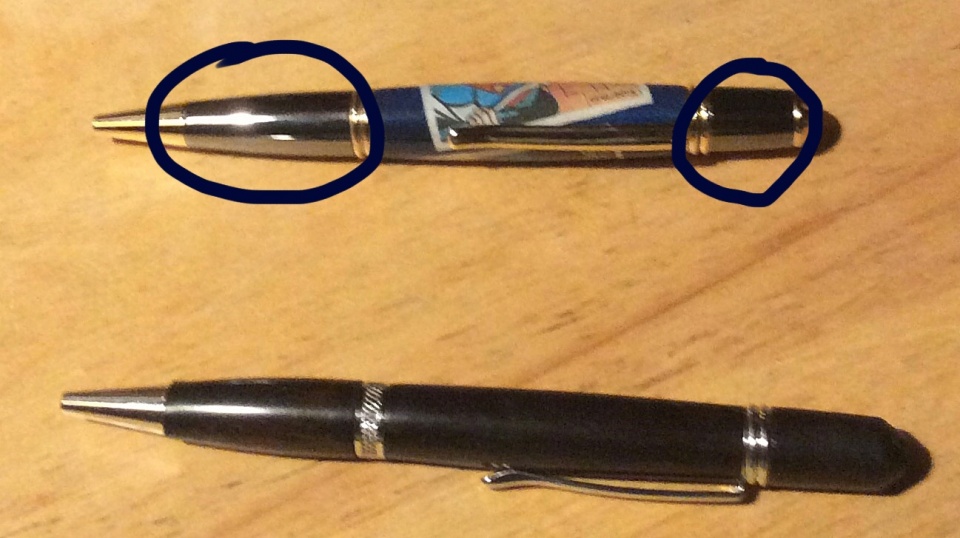

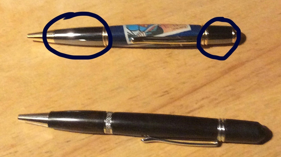

Ken,
I have circled the parts I am trying to replace on the upper pen (the gunmetal sleeves). I've replaced the sleeves on the lower pen but am not happy with the fit on the nose cone, there is very little wall thickness when trying to replace the thin metal sleeve.
