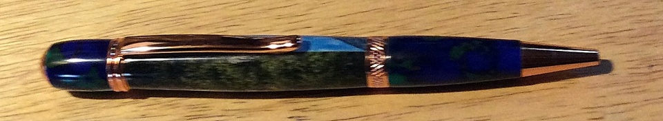

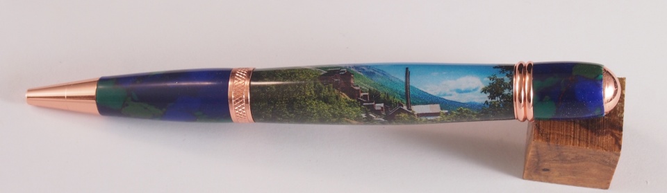

A friend and coworker recently returned from vacationing in Alaska and asked me to make a couple of pens. I shared one earlier this week. She wanted a second one incorporating copper, a photo casting of the Kennecott concentrating mill and azurite. Here is what I came up with. I had to modify a Wall Street II kit to meet her request. It was a challenge turning the Tru-Stone thin enough to replace the black bands that came with the kit. I would have liked to have gotten the top more streamlined but it was so getting so thin that it started getting a little distortion. I think that I am going to take a break from pens for a little while after this one.

What does the sea line look like on a photo casting like that? It's an absolutely beautiful pen
The seam is hidden under the clip for the most part. A 1/2" or so does show. You can put a border on the photo and hide the seam in the border. I went without the border on this one.
