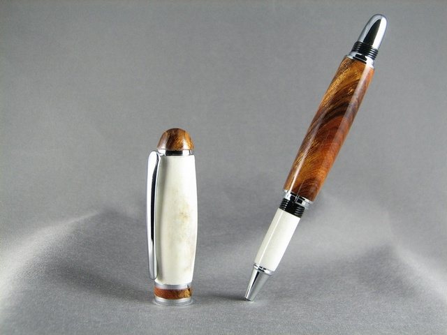

Here's a photo of a Baron/Sedona I made with antler around the nib. Might work.

I don't have either a metal lathe or a collet chuck, however, I have been looking for a good reason to buy the Beall chuck. I am intrigued with Rick's solution and am trying to figure out how to apply it to a Statesman. On the Sedona, the actual nib will unscrew, leaving the bottom assembly free to be mounted on a lathe. I can only assume that he turned an antler piece that was glued to the smooth section of the bottom assembly very thin so as not to impact the function of the threads. My only question to Rick is, how did you protect the protruding section that accepts the nib and the threads?

Like Bob said the nib on the Baron unscrews so it's fairly easy to mount it on the lathe. I used a dead center and a live one.Tighten very carefully and turn it to round using a small mill file. Cut a piece of antler from a tip so there is no marrow and drill a hole. Glue with epoxy, remount and very carefully turn to shape. Notice I used"very carefully" twice
