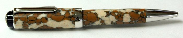

My favorite pen is the Havana Ballpoint- for its weight, balance and feel- but I wanted to try a different tip on it. I took the tip from a Jr. Gentlemens Ballpoint and fit the pen to it. This material is a sample that we're looking at. It's not available right now but may be in the future. It's a TruStone material (pulverized stone that is reformed through heat and pressure). I think the pen may look better with a gold or a Black TN finish, but I like it still.
I sanded through 3600 with MicroMesh then used 20/20 Plastics Polish to finish it. I was pretty surprised at how much the polish helped- good stuff! This pen will stay on my desk for personal use. Please feel free to comment.

I'm not a big fan of that kit as a ballpoint, but with the Jr. Gent ballpoint, it looks interesting. Also not sure that I care for the material.
My glowing review aside, this is yet another example of your typical, excellent craftsmanship Nils! Have you tried the MM for acrylic/Corian on the TruStone? It really does a great job (and it's something CSUSA carries, IIRC!) - better than standard MM, IMHO. I follow up with Hut Plastic Polish, which really gives the blanks a nice shine, much like the polish you used.
Michael, Trustone isn't much harder to turn than Corian or even PR, IMHO.

Like Jim said, TruStone is really pretty nice to turn. It's easier than celluloids because the shavings don't wrap around the mandrel as much. It's not bad on the tools either. We had just received these blanks in and I wanted to try one. I've probably made 15 Havana Ballpoints but I never kept one, so I was happy to make something for me.
