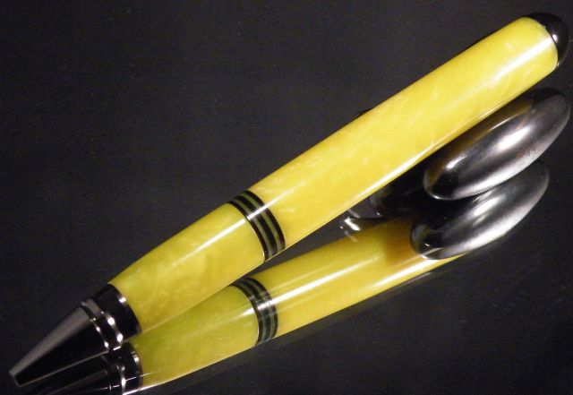

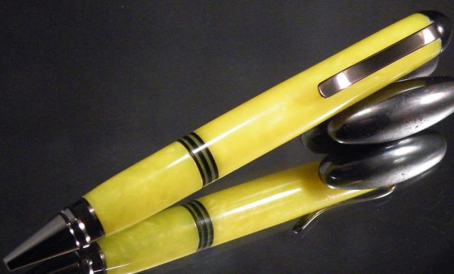

This is a modified cigar pen made for the Penmakers challenge stage 3 . It is made with yellow pearl and black PR with parts from a black Ti cigar kit .
It was modified along the Longwood design and makes a very beefy pen . I'm quite happy with this one and it will become my current carry pen .

Thanks guys . This blank came out of the post cure oven screaming that it wanted to be something different , so I put my sunglasses on and pulled it from the mold . This is the brightest blank I have ever made . This one is overloaded (about 10%) between the yellow dye and the white pearl mica so it took much longer to fully cure and was in the post cure oven for quite awhile , but it did not get brittle and was a dream to turn . When I decided what the next challenge pen was going to be , it was to only logical choice with the black Ti furniture . Even though it doesn't use the stock CB it is still as heavy as a regular cigar due to the size , it's .55" thick at it's thickest point and it has a nice solid feel .
