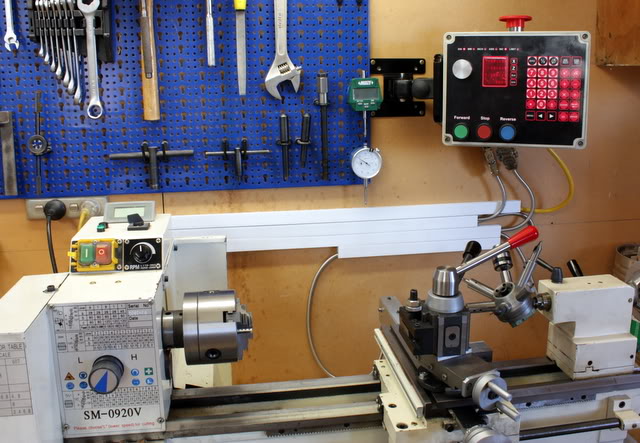

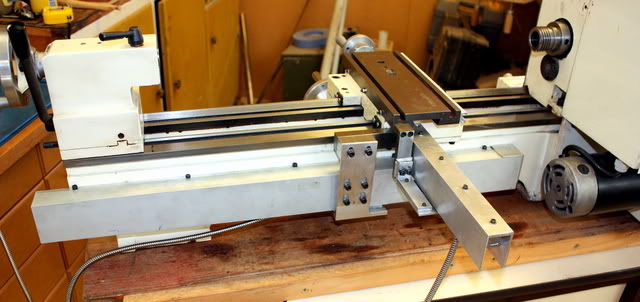

I was lucky enough to pick up a 2 axis DRO with glass scales on Ebay, it also came with a 3 phase motor controlled through a VFD which in turn is controlled through the DRO controls. Very nifty bit of equipment built from scratch by a very clever bloke.
You can read about it here if you are interested.
http://www.franksworkshop.com.au/Workshop/LatheDro/lathedro.htm
I haven't installed the 3 phase motor and VFD as my lathe already has EVS
Here is a shot of the DRO display mounted above the lathe
And a view of the glass scales installed on the X and Y axis.
I can switch from MM to Inch readouts at the press of a button, also whether it measures diameter or radius.

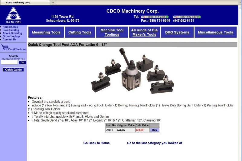

One of the first modfications I made to my 9x20 lathe was adding a QCTP (Quick Change Toolpost)
This enables you to quickly change to another tool and these can be pre-set to correct cutting height in the tool holders, rather than having to use a number of shims in the standard 4 way toolpost.
It comes with 5 different tool holders and additional ones can be purchased, including special ones for parting tools and boring bars, as well as a knurling one (which I don't like but more on that later).
At last count I had about 15 of these, at about $8-$9 each they get added to an order from CDCO to "fill up" space left in the Flat Rate box.

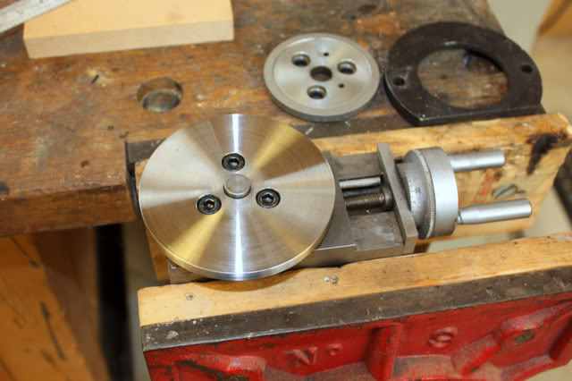

Another mod made was to make up a bigger base for the compound slide, the standard one being rather puny and prone to flexing.
Here is a size comparison between the origina base (laying on the bench) and the new one (mounted on the compound slide)
A work in progress shot

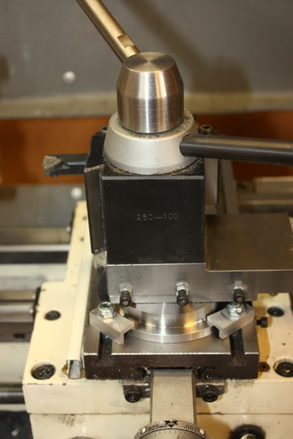

and mounted on the lathe with the QCTP and boring bar in holder

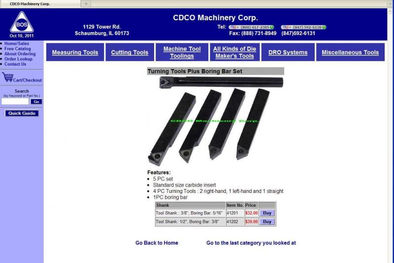

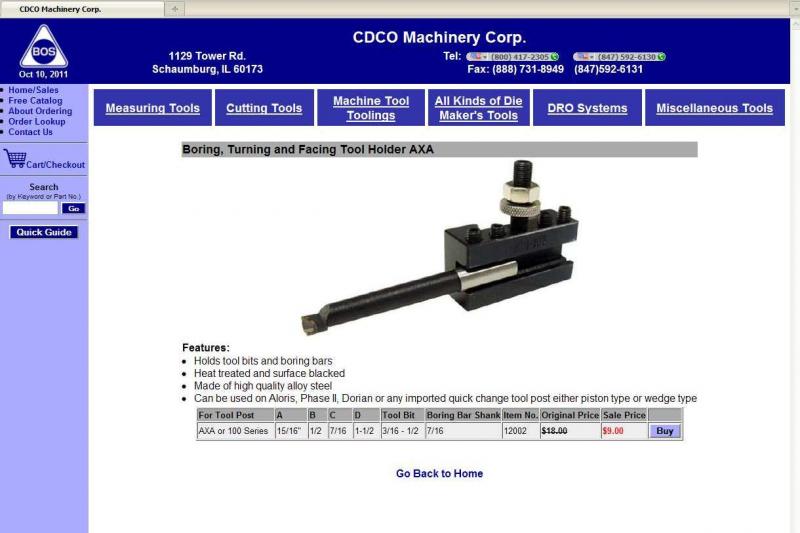

Fred can you send me a picture of that boring bar holder in this last picture.
Thanks. Lin.
Fred; Good piece of work!
Fred and All; This is a John Pitkin Donut Mount. It makes the compound MUCH STIFFER.

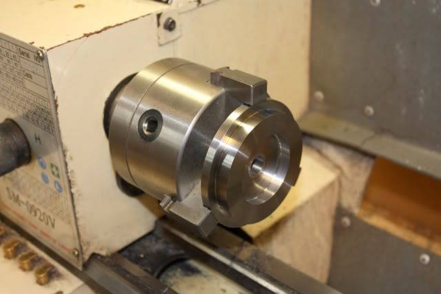

Lasty, here is a photo of my chuck. Notice how I marked it with blue dye? Every 3 jaw chuck has one adjusting hole that tightens down just a little straighter than the others. Check the runout at all three positions on yours and I'm pretty sure you'll find one that is better than the other two.
I used blue dye to mark mine so I can tighten it the same every time.
