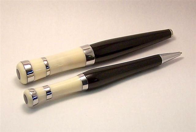

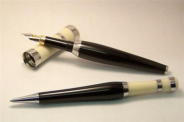

I had to take a quick visit to Zurich Switzerland last week and saw some cool pens in the Duty Free mag on the plane. BIG bucks!!! But I liked the styles so here are my versions. I don't want to get sued, so you will have to work out the clues to see the originals.;)
Black PR, Alt Ivory and Stainless Steel Nuts for the trim.
Comments and critiques welcome[8D] But I do know that I mixed up the cap end rings[:I]

Ed and Barry, no secret or black magic. I used to use a file before I got my metal lathe[;)] Even now, it can still be quicker and easier to use a file than trying to turn. But mostly I turn and polish the metal as much as possible before assembling the blank. Then just turn down to the metal as normal. Sometimes the polished metal gets scratched but no biggie as the plastic doesn't seem to absorb the black crud when it gets re-polished. ALL my sanding is done wet and I think that helps. Some will say that plastic doesn't absorb anything but the alternative ivory does appear to be porous and 'powdery' until polished. I think if it was done dry, then the metal dust may be ground into the plastic.[;)]
Also, stainless doesn't give off as much black muck as other metals.

Louis, unfortunately I used more kit bits than I would prefer. The FP threaded bits are from a wrecked Panache, the nib is from a set of pens that were advertised as 'indistructable' You may remember the advert where they show the pen being stabbed into a wooden board or thrown at a dart board. The slimline has a stock nib.
Bruce, you know your stuff mate[;)] But I don't think LOML would be too happy if I raided her jewelery box.[B)] One day I'll figure out how to make a suitable stainless clip.
