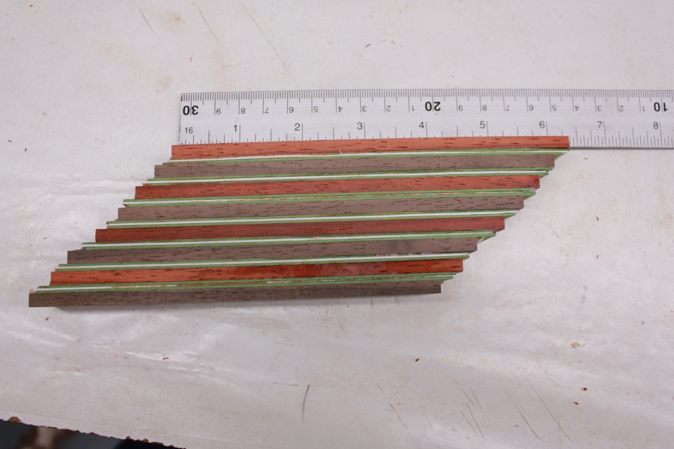

Ya know when you shouldn't have tried that last cut with a skew, or sanded just a little bit more, or whatever ruined a project?
I guess I should have waited until the morning than glued up some inlays late at night.
I almost didn't turn the blank, but I still was pleased with the alignment.
Gotta look carefully, two have walnut/walnut matches; two have walnut/padauk matches (which was my intent).

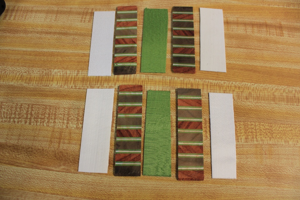

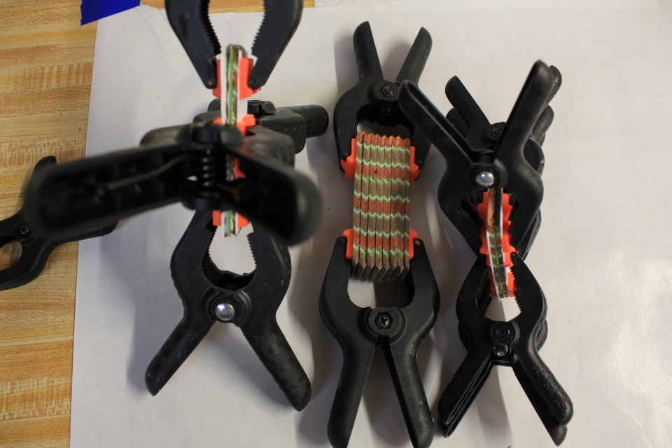

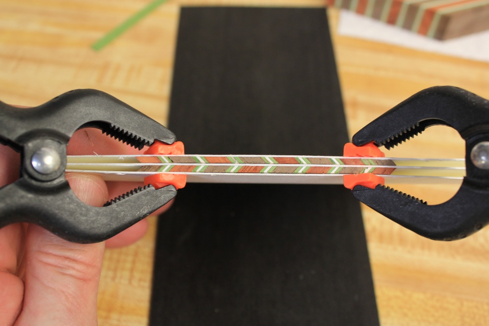

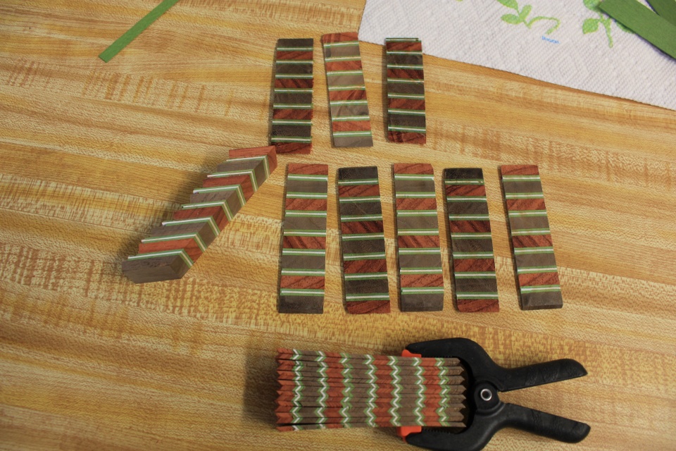

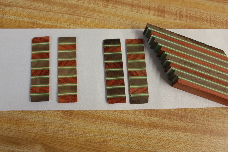

Process for those interested
Most of the essential process:

Yup, same pen. Two inlays are matching the Padauk/Walnut, two inlays have alternating walnut/padauk. Just an error when I glued up the inlays. A noobie segmenter mistake. :frown:

These are getting more fun. Having 6-7-8 layers in a block is much easier than 22-24. And the pattern in my opinion is nicer. Just got to pay attention. Kind of hard with less attention span available.

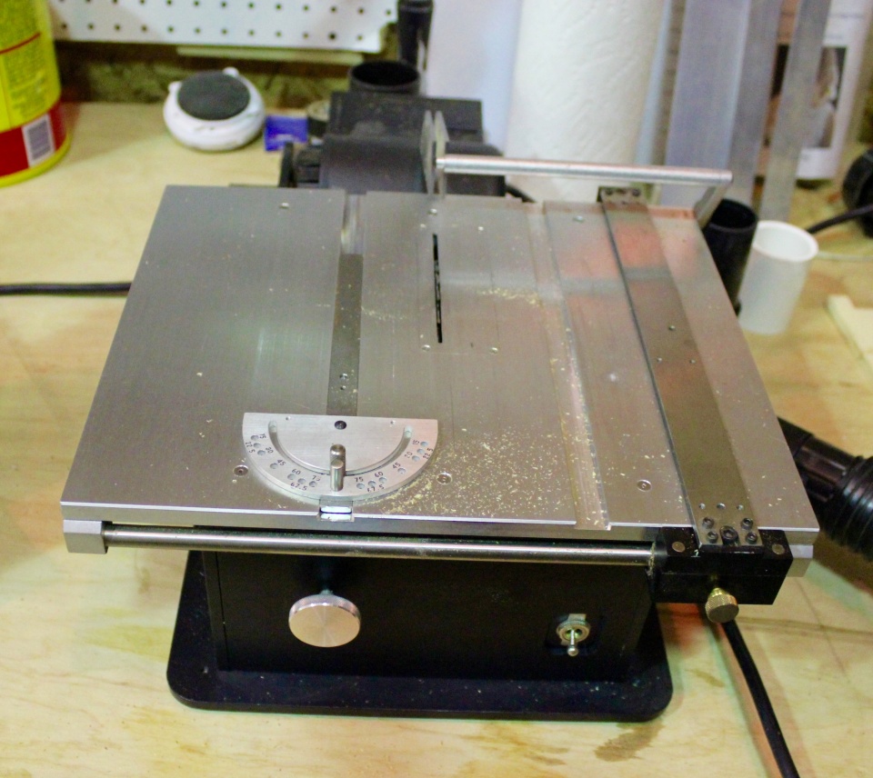

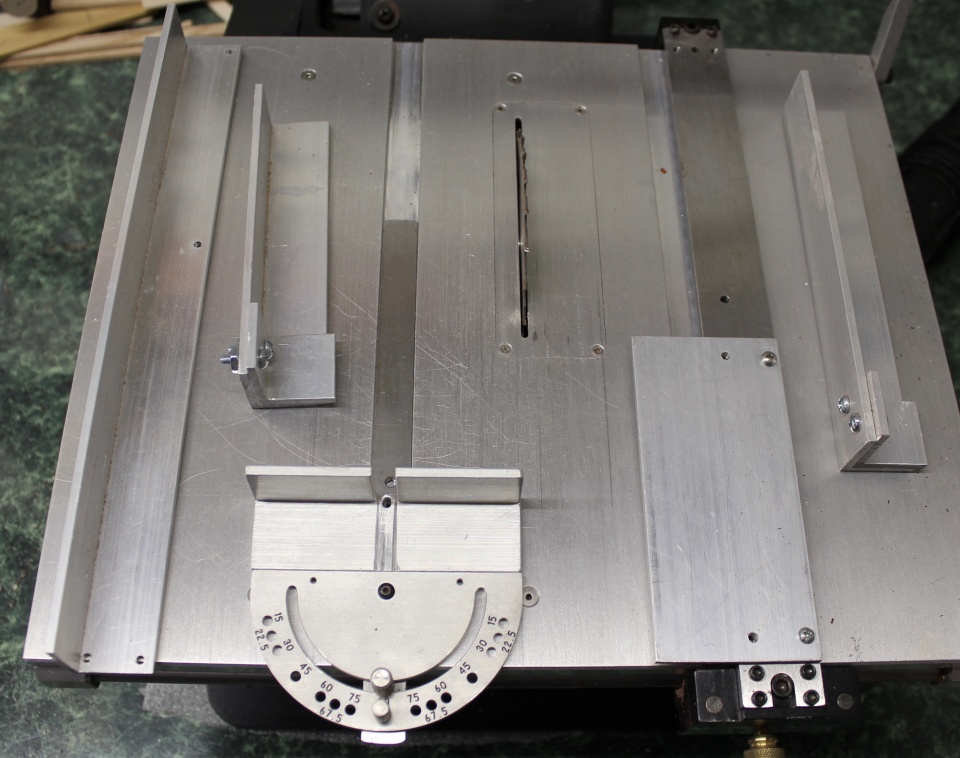

Mark, I'm really impressed with your segmenting. you are really providing great inspiration. What saw are you using? Do you use a sled? If so could you post a photo of your sled?
I am using the Byrnes Model Makers Table Saw. It has a blade clearance of only 15/16" (about), so when I construct my starting blocks, I keep them only about 3/4" thick.
I do not have a sled yet for the saw, just the miter gauge and a 45 degree piece of scrap. I really need to make a sled, or buy the one Byrnes just came out with (recently mentioned in another thread).
I'll say again, these are not that hard to make! Just be willing to learn from the first 3-4.

Hi Patrick, yes it is similar. If I could buy the inlay thick enough that would be much easier than making my own. But, I have looked at the inlay designs from the usual outlets for concepts; unfortunately, most are very thin, and would not work for pen blanks. They need to be minimum 3/8" and I actually use closer to 1/2". BUT, their designs are well worth peeking at!
