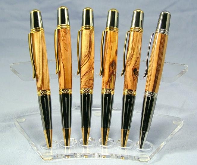

I had to make up a bunch of Sierra's for gifts and used some recycled tubes from some previous blanks that I turned down to the brass. I have the finished blanks (well, almost finished as I have to do the final sand & such before assembly today now that the CA has cured) all sitting on my table saw and noticed that 1 of them is noticably shorter than the others. I know the Sierra is pretty forgiving with it's sizing as I have used recycled tubes before with no problems, but this one is noticeably shorter and is in some nice BOW which I would hate to lose.
So does anyone know the minimum legth of the tube to make the sierra work without doing any funky modifying? If I do have to modify it, how would I go about it?

I had to do 13 Sierras and pulled some of my old blanks that didn't turn out well and turned them down to the brass to recycle them. I had a variance in sizes up to 3/16th" from the standard tubes, but everything went just fine. I was doing 11 of those Sierras in Bethlehem Olive Wood and it seemed that the best blanks were on the shortest tubes. The other 2 were done in Cocobolo. So all in all, things worked out well. Especially since my wife finally gets her Sierra in Platinum and Black Titanium with BOW blank. My wife's pen is the last one on the right.

Allen: I know this is a little after the fact; but the information may be useful to someone in the future. The tube length on the Sierra Twist kit is about 56.1 mm. I just got out a kit to measure up and it looks like you can shorten that by 6 mm. and the kit will still function properly. However, that is really pushing it and if you got a tube that was a little short, taking off another 6 mm. might be a disaster. To be on the safe side, you should stay away from tubes that are more than 5mm short of normal length. To say that another way, tubes shorter than 51.1 mm. (2.012") should probably be avoided unless you like to gamble!! On paper, you should be able to go down to 1.972"; but you have to like to live dangerously.
Scott told you that 1/8" short would work and you have already discovered that 3/16" short works. It looks like 15/64" ± a few thousandths is the extreme limit so you still had a little wiggle room.

That's pretty much what I came up with as I started putting the pens together and figured on anything less than 1/4" difference should work out ok.
