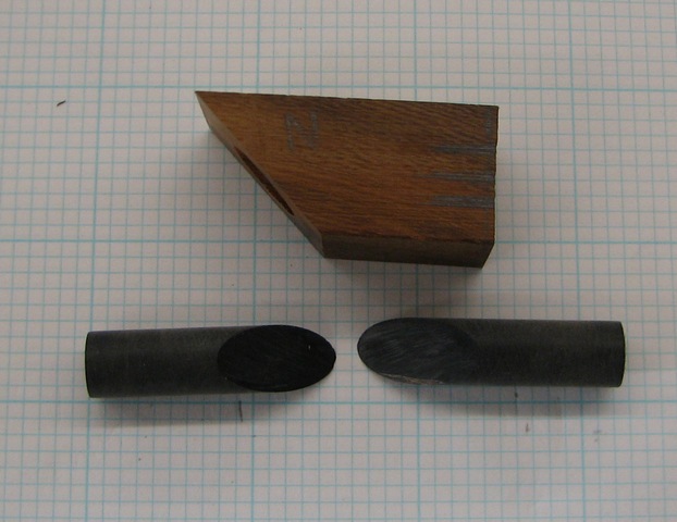

Very nice, Rick. I had much the same procedure in mind but hadn't tried it yet. The split delrin mandrel is a neat touch - I hadn't thought of that.

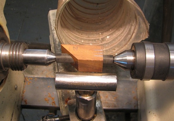

Barney, if both ends of the blank were square then you COULD just use the DIW, cut tenons on the ends to fit in the casing and not use the mahogany. BUT, since I have an angle on one end it makes it impossible to cut a tenon on that end.

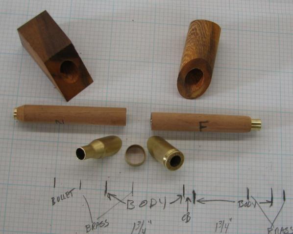

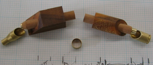

Sorry Rick looking again your pen parts I do have a question : do your CB is a bit slopy I mean moving around it seem to me that the CB ID is bigger than the mecanism oR do the bottom barrel is long enought to act as a tenon ?
Serge, the mahogany insert was left a little long to act as a tenon for the CB but it is a bit small. The CB was not glued in when I took the photo and it moved. I have since glued it and it fits fine.
