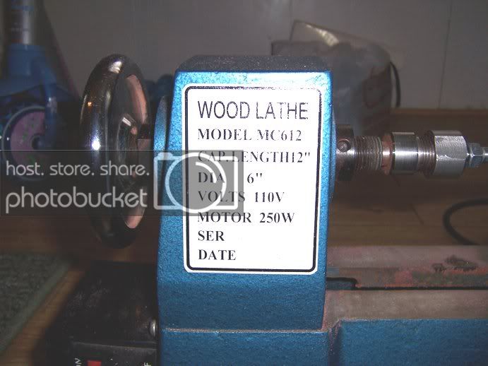

Ok, thanks for the tips guys. In case anyone is curious what the old thing looks like:

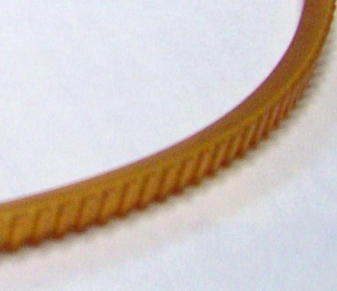

Some of the smaller HF lathes use a belt that is a v belt that looks like a toothed belt. The toothed part is the outside of the belt. I've tried to attach a picture of what the one I have looks like. Sorry the pic is a bit fuzzy.

That looks like the bits it spit out. I may try to clean it all out and see if I can find one of those link belts that'll work. I'm all for not doing more than I have to.
I like the naming of that machine "wood lathe". I bet they have all kinds of other ones like drill press and table saw :laugh:
Not to make fun of the machine..I'm sure it's just fine at what it does, but I am still laughing at the label on it!
