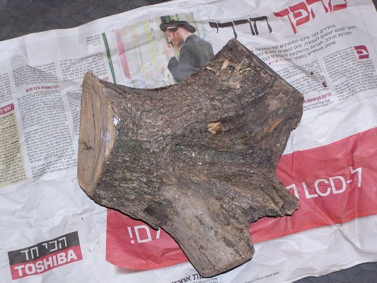

A neighbor of mine just got back from a business trip to Israel, specifically Jerusalem. Asked him to bring me back some olive wood if he could. He asked his driver about it, and the driver brought back this:

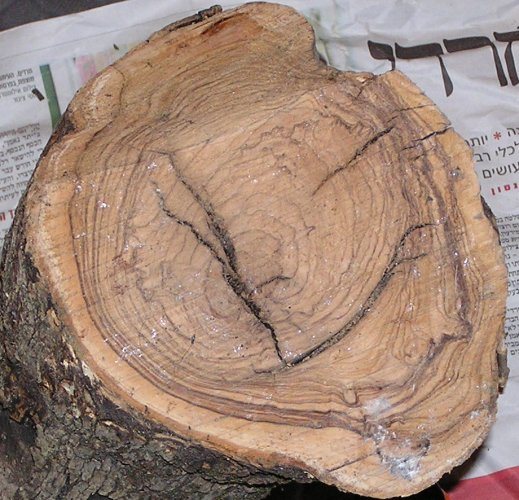

Dimension across the top is just shy of 12". I'm hoping for some interesting grain being a crotch section. He did raise a few eyebrows in Customs, both in the US and in Israel bringing this hunk of wood back. I've left the paper in the background to help validate its origins, no COA for this however. It does look to have a bit of spalting, here's a close up of the largest end.
Any suggestions on the best way to cut this down into blanks?
Cheers,
Draken

Draken,
You have a very nice neighbor to be willing to go through that trouvble for you. I think you owe him a pen or two [;)][:D].
That is a very nice piece of wood! I am sure it will even be better inside. As you can see, you may have some problems with cracks on this though. I you are aiming for maximum yield, follow the cracks. If you fight it, you will end up with a lot of blanks with cracks and may end up useless.
Milling olivewood is also not easy. Assuming you are using a bandsaw, it tend to gum up the blade and the wheel. Oiling (the blade) before you start is recommended.
GOOD LUCK and this is a nice gloat [:)]
