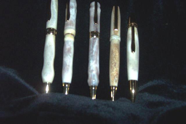

Here are pictures that Eagle spoke of a couple of posts above. I didn't do a stunning job on retouching, but I think you can see how amazing some of the coloring is, how well he produces these suckers and that his process sure seems to work!
