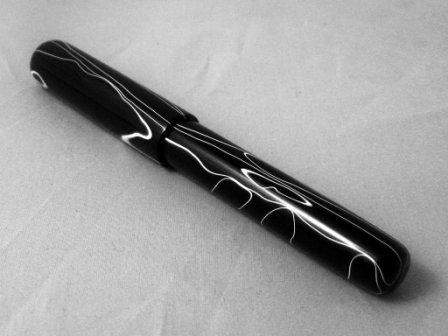

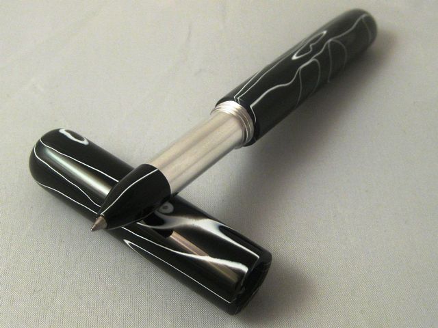

I finally finished this kitless rollerball this week. This one entailed many firsts: first closed end, first hand threading, and most importantly, first kitless. Needless to say there was a lot of trial an error but I think I have it down now. I like the acrylic tip because it is not something that someone would expect to see as they remove the cap (IMO). As always, comments are welcome. I'll post some better pictures this weekend. Thanks.

Very cool Gary. I like that ALOT.
What's the grip made of? Aluminum? Stainless?
Thanks Lupe! It's actually 6061 aluminum. I was able to put a good shine on it by putting it on the buffing wheel for awhile. The next one will probably be stainless now that I have the technique down.
