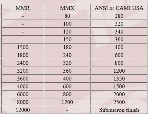

Micromesh Grades
Here's a chart I have that shows grit equivalents for the 6000 and 8000 but just says sub micron for the 12000 , hope this helps
I have no idea what the comparable grit is. I read years ago that it is finer than Novus #3, but not as fine as Novus #2. For those that use Novus, like myself, it's a good tidbit of knowledge.
An approximate rule-of-thumb is to multiply the MMX grit by about 7 to get the MMR grit.
