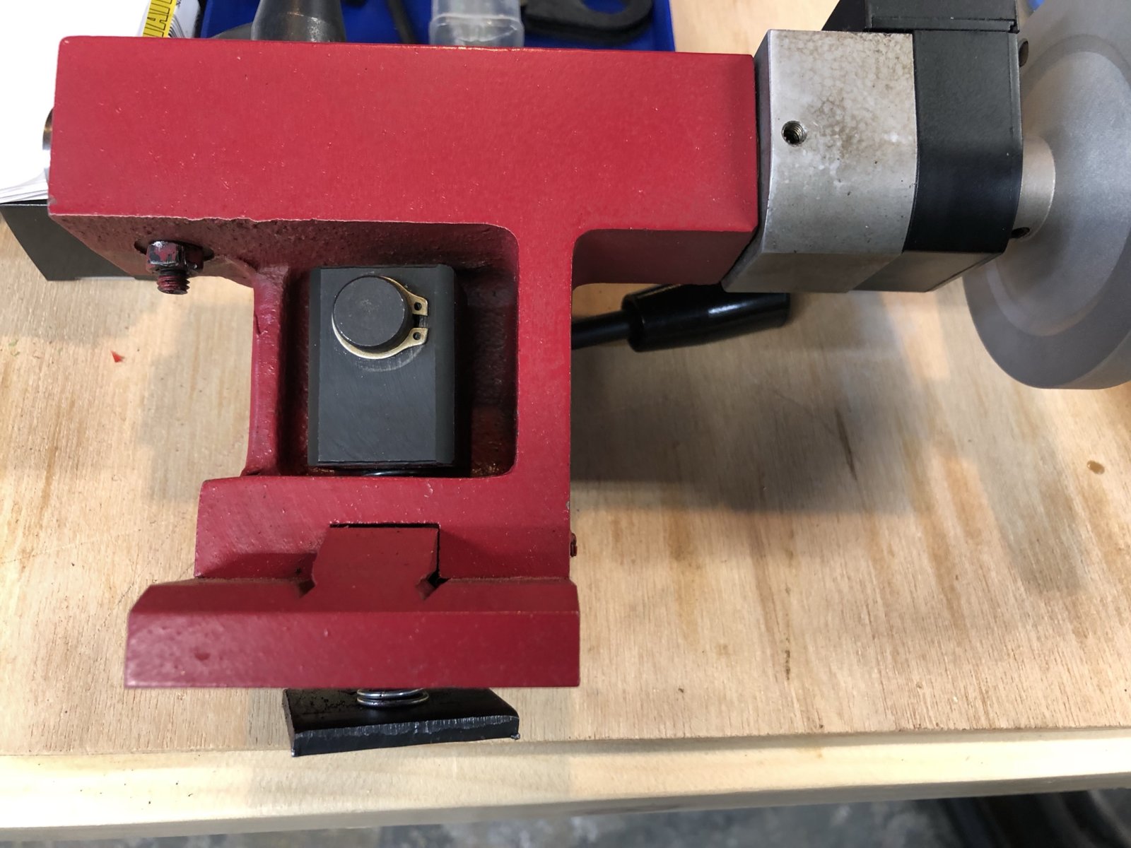

Does the camlock for the tailstock work reliably ?
I hated the tailstock nut/clamp and I LOVE the camlock. The LMS upgrade kit requires that you drill a hole in your tailstock but it is easy to do. Probably my favorite upgrade.
For me, the QCTP is really worth it too. Trying to shim different tools to the correct height drove me crazy with the standard tool post setup. Being able to just turn a screw to adjust height and to change tools really quickly is a real convenience that I appreciate.
I like my DRO too (I installed the LMS kits) but I could probably live without it. I like the tailstock DRO for critical drilling depths, but I honestly don't use the others too much even though they are cool to have.
I haven't upgraded the handwheels yet but it is on my list. My machine isn't very old but the handwheels are indeed wobbly and I don't like the feel. I may try making my own instead of buying though.
So, I take it that you find the tailstock camlock effective and reliable ?
I have reservations about installing the mod kit because I am not sure how it works. . Does it basically just force the bolt to an angled position ?
I find it very effective; sometimes you have to give it a good tug to make sure it is tight, but I haven't had any real problems with it unless I'm working fast and sloppily. Here's a pic of the camlock assembly so you can get an idea of how it works: the lever in back engages an eccentric bolt (the hole you have to drill accommodates the through-bolt) which lifts the plate at bottom against the ways.
