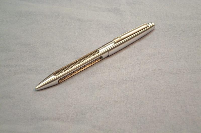

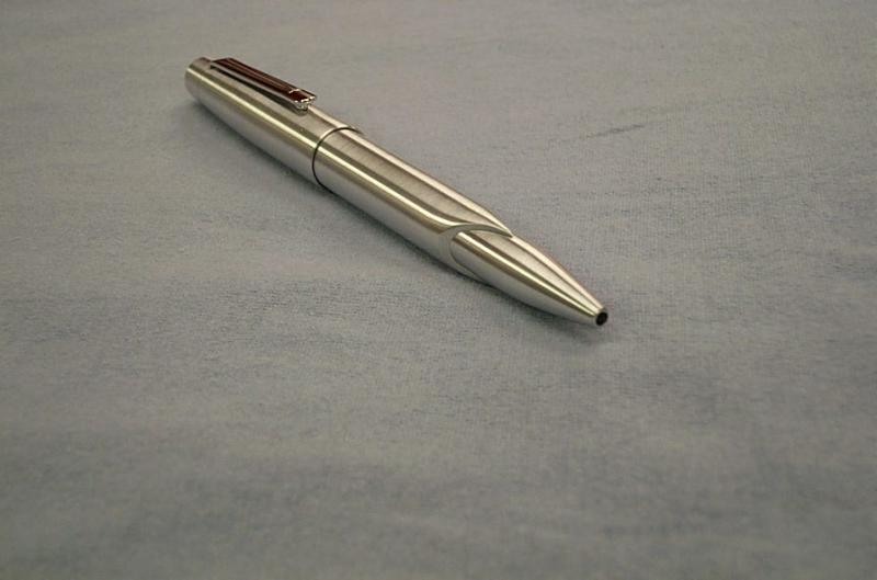

These are a couple ballpoint pens that I made in 2003 before metal pens in penturning were fashionable:biggrin: They're to illustrate that it can be turned, filed, sanded, and even routed. On the one the barrel was turned then sanded against a drum sander to form the points. On the other, I used stainless braided brake line inside the barrel. But the windows that show the stainless were done with a laminate trimmer and a carbide tipped router bit. The finials are also hand turned. Hope this piques your interest. I'd like to see more people try it.
Mike

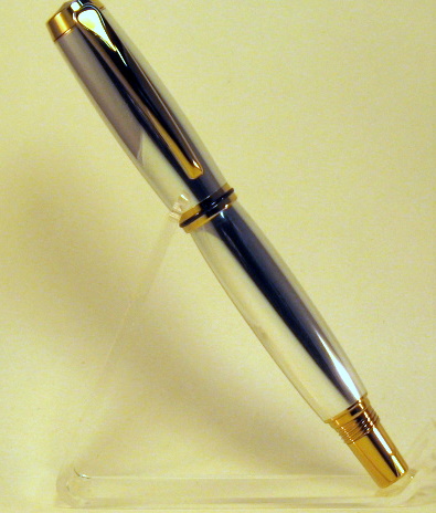

Here's a pen I made from blanks made by johnnycnc, turned on a wood lathe using a skew chisel.
