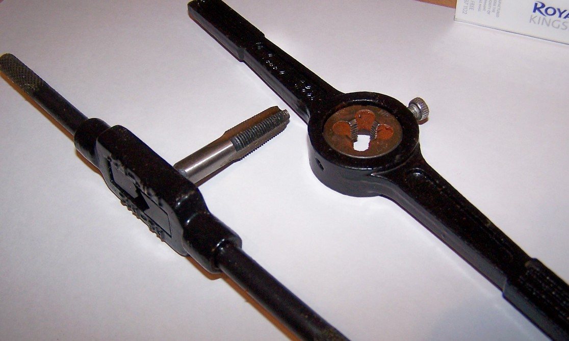

Wanna see some really hi-tech thread cutting jigs? And for internal and external threads?????
....wait for it.... there good....
<br />

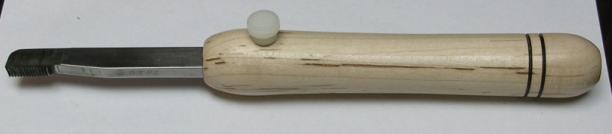

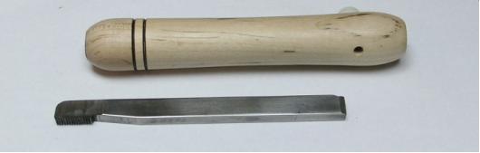

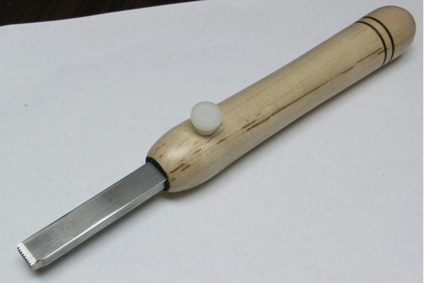

Thread chasers are also available for use with wood. I picked this one up recently that does both inside and outside threads in one combo tool.
<br />
Set up for inside threads:
<br />
Set up for outside threads:
<br />
