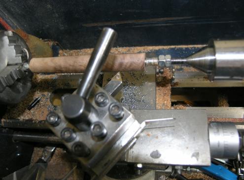

TCMT 21.51 inserts in a shop made QCTP for me. I cut in both directions and take the final cuts in the direction that gives the best finish.

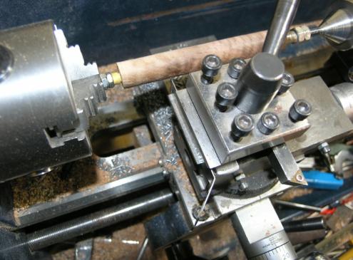

Also use a four position tool post with a carbide insert in one side. One of the pens I make needs a slot for the clip which is cut as shown in this photo.
The other side of the 4 position tool post holds an automotive style feeler gauge. This tool is rotated into postion and used to cut grooves. The feeler guage provides for exact measurement of the grooves and the tool is marked as to size.
Any tapers on the ends are made with a bar in the tool post and cut by hand held skew.
