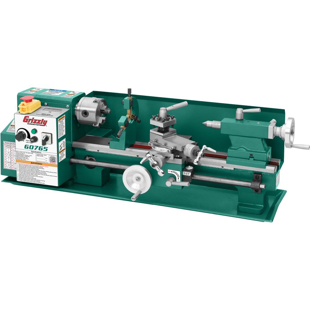

<h1>G0765 7" x 14" Variable-Speed Benchtop Metal Lathe</h1><h2>A small bench lathe with impressive torque for small parts production.</h2><p>First and foremost, it features a special "Big Boy" tailstock which was designed with the same convenient quick-locking controls and extra-long footprint...

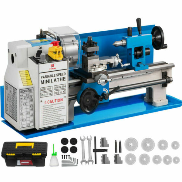

Find many great new & used options and get the best deals for VEVOR Precision Mini Metal Lathe Metalworking Benchtop 550W at the best online prices at eBay! Free shipping for many products!
