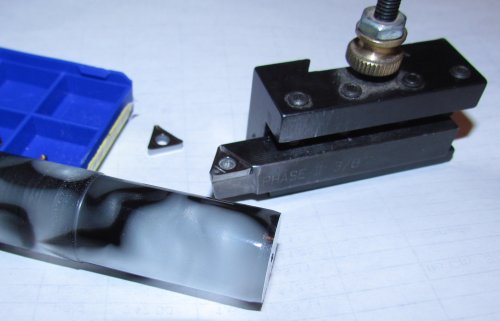

David, If you use the little triangular indexable cutters with the 7/64" hole I could wholeheartedly recommend a cutter I just bought yesterday. I've been wanting smoother cuts on aluminum so ordered some of these from Shars tooling and WOW...... the difference (without doing anything else) between the carbide cutters I have been using and these is daylight and dark!
I grabbed a piece of acrylic that I previously rounded with a carbide cutter and turned a bit on the end with the new cutter. This photo isn't the best but I made one cut then another shaving off just .001" then took it to the buffer without sanding, it was THAT smooth!
If interested, it is a TCGX-LH cutter for aluminum, Shar's http://shars.com part number is #424-1660. This will be a hard cutter to beat for acrylics... and aluminum! :smile:

BTW, I use indexable gold ti finished carbide cutters. Inserts are dirt cheap, last forever and, depending on how you angle them, make excellent deep and finishing cuts.
The website does not show that cutter. Where did you pick it up?
Found it. Great price too.
