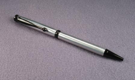

Pretty much the way I do it except, I drill 1st and then turn the whole blank between centers. Here's a slimline I just did, I did do it with the centerband just to see what it would look like, didn't.
James
