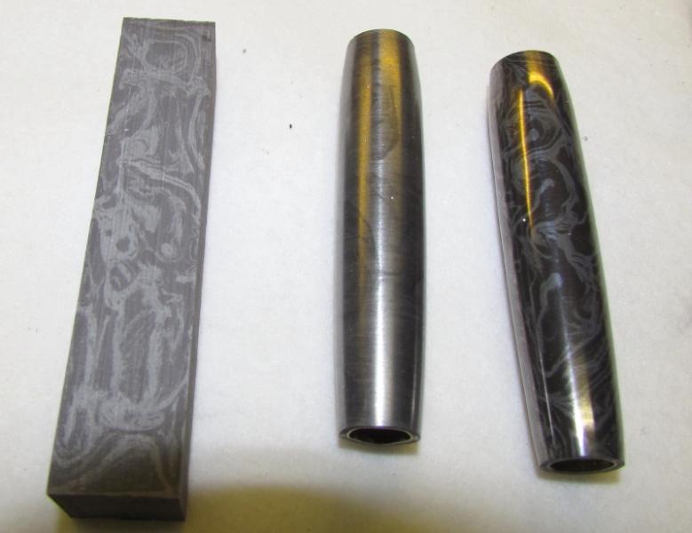

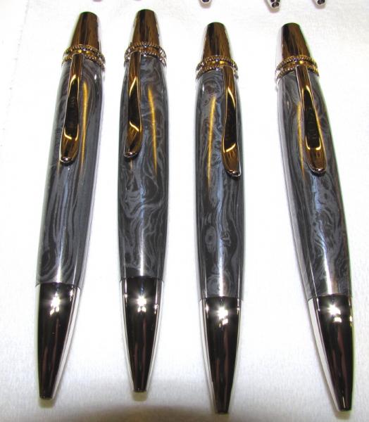

So, all made!

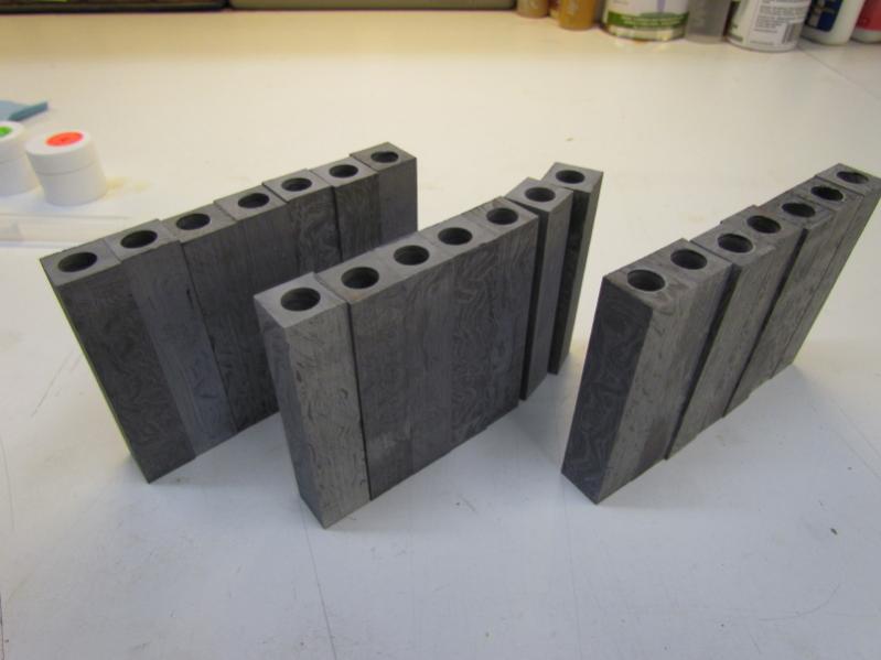

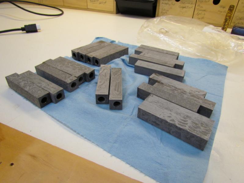

I did order the blocks from M3 Metal blanks HOWEVER, they called and told me cutting them up would not work, as the pattern is designed per blank and cutting them up will remove the pattern somewhat and will not give a good end result.
So, they cut me a deal and I ordered all in 3/8x3/8x6" blanks and did the project. Little room for error in the drilling though.
Sold 21 of them for $35 profit per pen, so am happy with that.
Not the easiest thing I've ever turned and I found plastic polish works as well or better than the metal polish.
Will post picture soon.

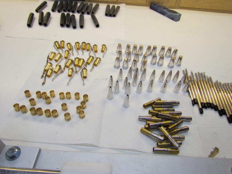

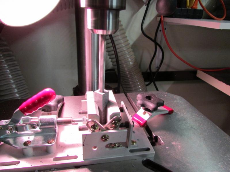

Here are the pictures.
