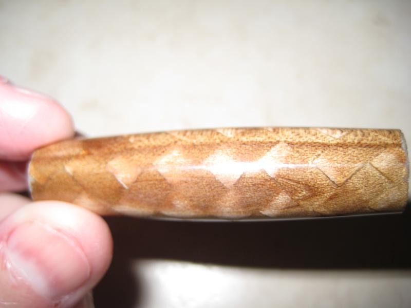

I turned the pen down and was all set to do sanding, but as I got into the finer grits, I realized that there were areas that weren't shiny, and realized that I'd ended up sanding through and was now hitting the actual wood blank. I'd purposely made the pen rather plump in the middle, because I was wary about sanding through the PR, but apparently I still turned it down too far. I definitely don't see how one could do a bushing to bushing turning with this.
So then I applied a CA finish to the blank and managed to get a nice shine all around. Then it was time to assemble the pen. Yep, you guessed it, I had sanded out so much of the brass tube in the middle that it just fits loosely over the nib part of the sierra pen, so when I saw that it wouldn't even stay on the nib section, I didn't bother putting it together actually and pressing the clip end into the barrel, which probably also would have been too loose.

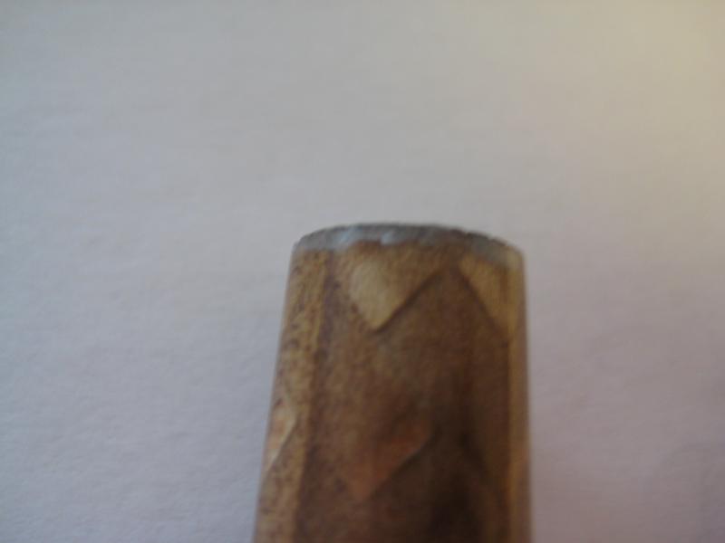

Also, for some reasons the ends of the tubes turned sort of muddy looking. I'm not sure if it was the brass showing through and maybe a larger exacerbation of what I saw through the casting where it looked like I had split part of the tube, but it sort of looked like that, as if somehow my casting muddied up the ends of the tubes. So even if I could figure out some way to put a thin layer into the inside of the brass tube so that it'd fit tightly, I'm not sure I would make it into an actual pen, since I think you'd be able to clearly see how the area right between the end of the tube and the pen hardware on the kit just didn't look very good. I couldn't get a good picture of this with my camera, but the best way I can describe it is muddy and discolored.

I'll try to attach some pix to show some of the things I referred to in the review... The first picture is to show how the CA finish wasn't consistent and there were some dull areas. The second picture is to show the end that I'm trying to describe looking muddy.
