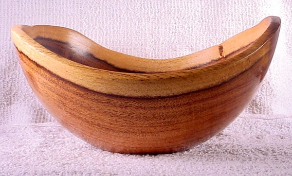

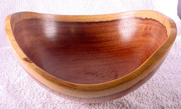

This is my first successful NE bowl. It's about 9"x5". All of my knuckles made it through unharmed so that was an accomplishment.

That wood is why I wanted to start turning in the first place.. I saw a NE Mesquite bowl down in Texas on one of my tours that I feel in love with... gave me the urge to get into wood turning... hooked ever since... I've only done one NE myself.. it was a Walnut with the bark still on the edge... turned out okay, but I didn't get the bottom like I wanted it and was trying to sand it better... went right through the bottom.. didn't realize how thin I had cut the bottom... I saved all my knuckles too.
REALLY a good job here... Probably my most favorite wood.

Thanks everyone.
J.C., I used Watco Danish oil with a few coats of shellac over that followed be a trip to the buffing wheel.
Jeff, The bark is now in many pieces all over the shop floor, although some of it may have made it to the trash. Not all NE pieces have the bark, my next few won't either, but this time it will be intentional not a "design oppertunity".
Jason, Mike cored that BEB piece I got from you. I oriented it so it was pretty flat on top though. The blank liberated itself from the chuck once but after a re-chuck all went well.

If you want to keep the bark on a NE, I read some where and have talked to a couple of turners at local shows... you almost always need to run some CA or other thin glue around the edge under the bark... I did that with mine and the bark stayed fine.. I just cut the bottom out with the sander trying to fix a problem with the bottom.
How did you do the bottom... did you reverse chuck with a jam chuck... Still trying to get that part worked out successfully.

I lost a huge piece of bark at the very beginning. It was pretty loose to begin with. I had grand plans of texturing and burning the edge, but hey I'm lazy.
I had this on a glue block due to the bowl liberating itself from the tenon which was my fault for having it right next to the pith. Anyway I just parted it down to about 3/4" then used a pull saw and cut the rest. Then I used a chisel to clean up the remainder of tenon and power sanded it smooth. Easy like pie.
I am in process of building a vacuum chuck for just this type bowl.
