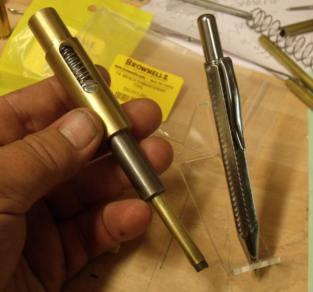

I guess this is a question / topic primarily for folks that cutomise their rifle bolts.
I recently bought this little tool from Brownells USA ( The gunsmiths ) to see if I could make it work on my stainless pens.
It works but no matter what I try, I struggle to get consistant results.
I've tried the Cratex rods on their own, with WD40, with a mix of WD40 and very fine valve grinding paste and just the paste. Aaargh!!!:rolleyes:
I know the secret is to make sure you use the same pressure for the same amount of time so I made the spring loaded carrier for the tool to take care of the pressure, and counted to ten with a metronome for each step.
One of the things that worries me is the illogical action. :confused:
You grind /polish a full circle, then move the tool to make the next overlapping circle. The first circle was on perfectly polished stainless, but the next circle now has to cut through half of the first one just to get rid of the scratches and then gring it's own circle. If you continue with this sequence, then each grind has to be progressively deeper till you can actually feel the grind with your fingernail. Not nice.
There is a Youtube vid or two but they don't really show a lot.
Any clever tricks or advise will be welcome please :biggrin:
This little pen looks ok-ish in natural light but under bright lights it looks like I ground it on a bench grinder:redface:
Edit in; I just added the close up shot that shows the different scratch pattern on each circle. I need them all the same. :redface:

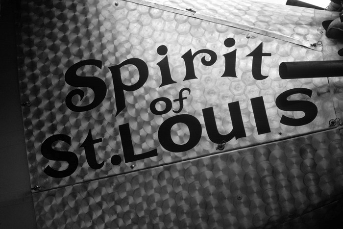

I'm not sure if you are familiar with this technique. It has dozens of names and I don't think anyone actually know the proper name. The most common name is Jeweling. I have no idea why they called it Damascening because that ( IIRC ) is actually inlaying metal into metal. Perhaps like Damascus steel it originates from there too.
It is also often called Engine Turning but I think that is an insult to that art form.:biggrin:
Here you go Roy. This has got to be the most famous picture of 'Engine Turning' in the world. Charles Lindburgh's Spirit of St Louis. :biggrin:

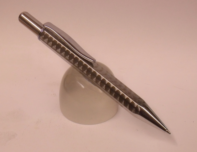

Billy you might be on to something. I'll try half as much pressure for twice as long. :wink:
Well Billy, I think you got it!! I used less pressure, longer time and cranked the rpm up to 750.
Cratex rods on their own, no lube or paste added.
Still need more practice but at least it's shiney :biggrin:
This little pen is about the same size as an Elegant Beauty and weighs just under 48grams
Also is a pic of it set up in my super-duper-hi-tech-jiggery thing !!
Learning is fun but aaargh!!! these are boring :turtle: to do!!!

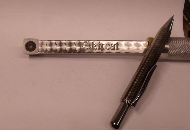

Skip, I made a tool for my mill, that has a spring loaded wooden dowel's which I glued a piece of hard leather, I use a peck drill cycle and use Valve grinding compound, I programmed the mill to move X half the distance of the leather disk, I have 3 different sizes, I think the one I did on the tool Roller Bob sent you was done with 3/8 pad,
Over here we call it engine turning, I have no Idea where it came from, but I learned it from my Dad who used to open Safe Deposit boxes, and since the box doors were done that way, I got to plug the hole from drilling then try and match the area around it.
All I had was the shop drill press and a can of valve grinding compound I use a spindle speed of about 500 rpm and peck down about 10 times per and the dwell is probably 6 to 8 seconds per fish eye, that's what it looks like to me, but that's the way I do the presentation tools, or the ones for special guys like you!!!!
Ken, that is still one of my most prized possesions !! That and my Silver Skiprat badge !!:biggrin:
I'm going to find some tough old leather ( I might have some in the bottom of my undies drawer ) and see if I can do like you did. :biggrin:

Having had another look at my Custom Woodchuck and with Ken's mention of 'Pecking' I changed it again !!:rolleyes: Still using the Cratex.
I altered the spacing and reduced the time in contact to 5 seconds.
Starting to look presentable now even though the pic doesn't show the sparkle effect.
My wife and daughter both said...'Hey, that's pretty !!' and that's good enough for me:biggrin:
