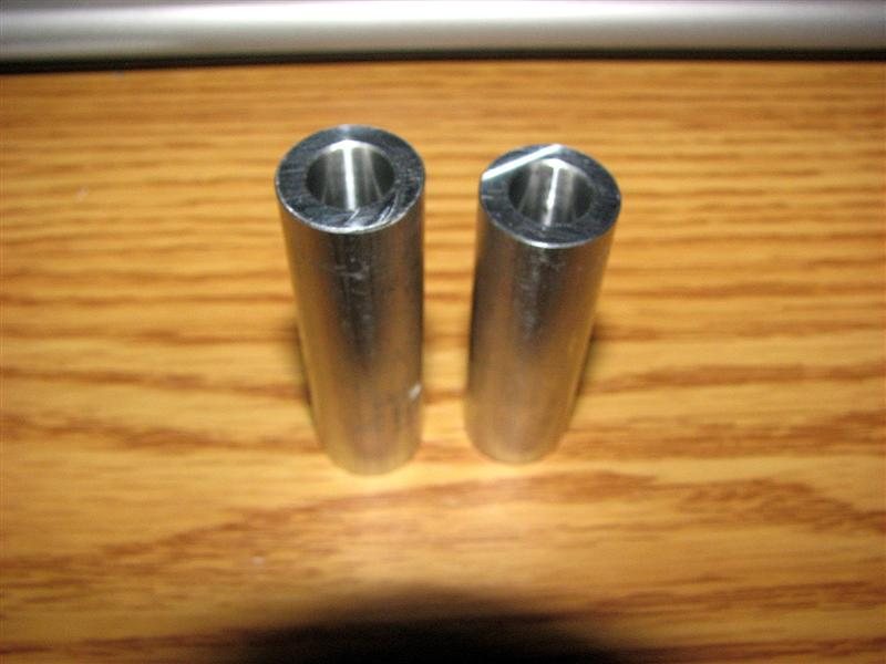

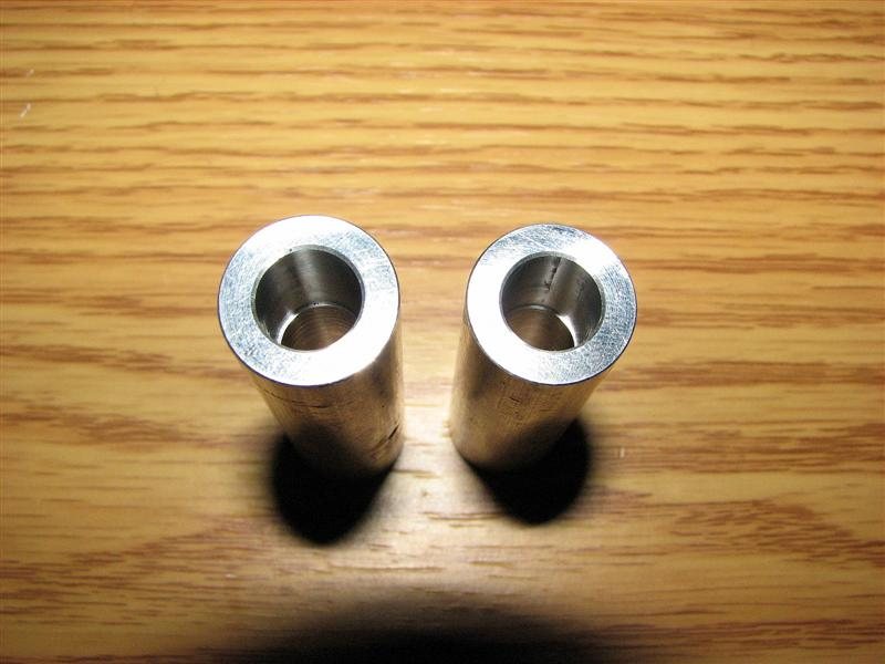

Hiya,Jeff I'm guessing you have something similar
to this cigar set in mind?
<br />
<br />
6061 is a very common,popular aluminum grade.
These are prototypes,have not had time to turn yet.
First,I squared the ends and made them same length as tubes.
No pen milling,or end squaring needed.
There is a hole drilled thru,almost as big as the
fittings,then I cnc machine a precision bore for the
fittings.these will have .0005 per side press fit.
No tubes.
I can get you measurements,for your set,but it kind of depends
on your idea of fit for your kit parts.I would recommend
.0005 per side press fit.And likely a drill won't produce
exactly the size you want to a close tolerance.Maybe,but not
likely.[;)]
Hope this helps.

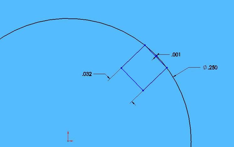

Your first two replies are very good ones and the cheapest and easiest way to go. The third reply will be the most accurate and the easiest for me since I work Quality control in a machine shop. The trouble with measuring the inside of a brass tube is threefold. First off, and I know I'm going to get arguments about this, a caliper is only good to +/- .001" according to ISO standards. While perfectly acceptable for most woodworking tasks I would question it's usefulness in this case. The second and third reason are as follows. The brass tube can and and probably will flex while measuring to be slightly out of round throwing off your reading and the jaws of the caliper are flat. I know that the flats are very small but in my field we routinely measure to .0001 (one ten-thousandth) and under.
I have added an illustration that I hope will make my point a little more clear.
Lets suppose your brass tube is 1/4" inside diameter (.250") and the flats of your vernier are 1/32" (.032"). You can see where the edges of the flat contact the tube but leave a gap. In this case the gap is .001" per side so in theory your tube that is actually .250" in diameter will read .248" on your caliper. (In truth it should read slightly less that .248" because the contact edges of the caliper are offset from each other a small amount for clearance but that is for another discussion.)
A decent micrometer capable of measurements to .0001" is available for less than $10.00 here:
http://littlemachineshop.com/products/product_view.php?ProductID=2877
(OK, with shipping it will be a little more than $10.00 but you can get my point) And for penturning you can find as many uses for it as a caliper.
