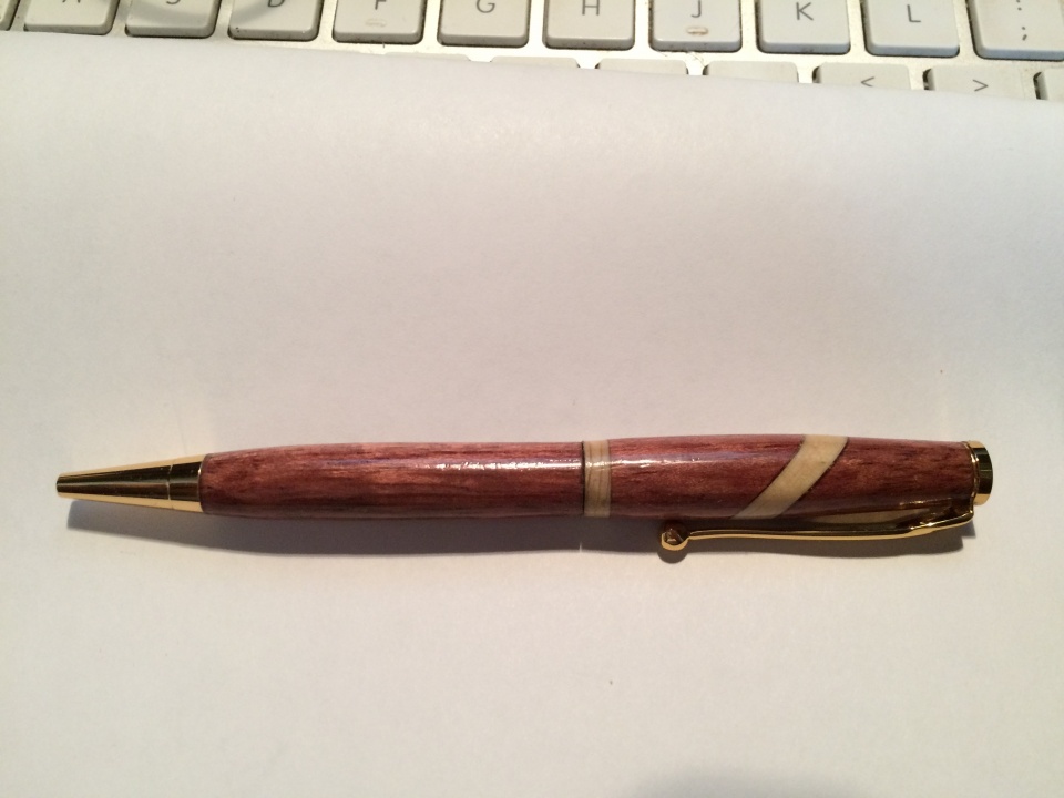

Can someone offer some advice about matching the upper and lower barrels of slimlines. I have decided to put my efforts into slimline modifications. As nice as the other pens are, they really aren't mine...
The problem I have is matching the upper and lower barrels. I have attached a sample. Maybe you can see where the barrels meet and are just a hair off. What is the best way to deal with this?
Am I just not exact enough in turning?
Would it be better to fit the bottom barrel a little into the top?
How did yinz (I'm from Pittsburgh:smile:) deal with this issue.
Any ideas would very much appreciated.
ps..When reviewing the pic I just noticed the tool marks I left in the pen...sheesh!

Well, I was going to reply, but then I noticed you were from Pittsburgh . . .
But, as an act of good sportsmanship, I'll comment. I am guessing you are referring to the slight difference between the lower barrel and the lower edge of your custom centerband. A good set of calipers will help get those really close - and you may have to measure during your sanding process to make sure the final diameters match.

Are you using a pen mandrel, if so square your blanks and butt the upper an lower barrels together on the mandrel and turn as if it was one long barrel. You might still have issues if they are a little out of round or if the transmission is not pushed in perfectly straight.
I'm not sure what you are referring to but if there is a gap between the bottom barrel and the custom ring I can think of two problems.
1. If it goes all the way around the pen then you may have been over aggressive squaring the ends leaving the brass tube protruding slightly.
2. If it doesn't go all the way around the pen then you didn't square the ends well.
I don't see a gap. It looks like the bottom barrel near the center ring is blackened. This can be caused by sanding dust from the bushings.
Sorry about being unclear. The diameter is the same... no problem there. The issue is that the butt ends are a little off. If you look at the shadow of the pen in the picture you can see what I mean.

I see the gap in the shadow! Using a pen mill can still cause the two problems I describe for several reasons. You can still over mill the ends and remove too much wood below the brass tube. Also, if the mill doesn't have a good fit into the brass tube it will cut unevenly. Third, if you have sharpened your mill and not done it correctly it can cause various problems.
It is only a guess but I think you over milled and the brass tube is sticking out a tiny, tiny amount.
You may also have some of your finish on the ends preventing them from coming together. Do you clean up the ends after you apply your finish?
I think the mill (or my use of it) might be the problem. As a matter of fact I did buy a new one because I thought that maybe I sharpened it incorrectly. But I still don't like the iffy situation I get when milling the end of a tube. I can't actually see what I'm doing until its done. Do you think it would be better to rig up a jig to use a sanding disc. I figured that I could keep everything easily squared up by using the lathe. And then some sort of off-center rig to keep from burning up the center of the sand paper. I don't know--that's why I am looking for advice. I don't think I'm the first person with this issue.

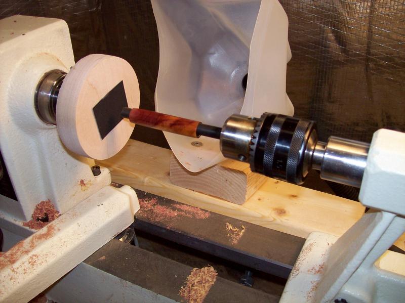

I use the mill to do mine. Just need to go slow and easy when you get close and check often. I have a simple jig for my lathe if I want to use it. For cleaning up the end after finishing I use the lathe jig. It's just a piece of wood I tapped to thread onto my headstock. I flattened the end and stick a piece of sandpaper on it. I put a Jacobs chuck with a rod in the tailstock. Slide the blank onto the rod and bring it up to the sandpaper.

Ditch the pen mill and do as in the post above. It's easy to make (or purchase) a flat disc to chuck in your headstock. Use a drill chuck in the tailstock and get a set of punches (cheap on Amazon and you can also use them to take pens apart when needed). Chuck the appropriately sized punch in the chuck, put the tubed blank on and press against the sanding disc (at slow speed).
I had gaps on the few pens I used the mill with. Now squaring on the lathe, no problems. Also, you can square up brittle blanks this way that the pen mill would shatter.
