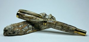

This Mastodon Tusk has been estimated to be between 12,000 and 15,000 years old. It was excavated near Columbus, Georgia in 1998. This was the most difficult material I have had the pleasure to turn.​
Shout out to Druid for doing the stabilizing​

Have you had experience with Mastodon Tusk?
Before the stabilizing, it was like a block of talcum powder. Even with the stabilizing, it is very crumbly. I lost the first piece during drilling. I used water to keep the drill bit cool, bad idea. I have enough to make one more pen. Fingers crossed.

Thanks for posting Richard. I remember when the tusk arrived and had my first chance to look at it. My first thought was this thing is going to blow away like talc! I was skeptical at first for what stabilizing method to use which is precisely why we tested the smaller piece. Bottom line, I didnt use a traditional stabilizing approach, the pen looks awsome and I bet will last as long as that tusk has been around... that is... don't let Ed finish it! :tongue: :biggrin::tongue:
Great craftsmanship, you did yourself proud and I'm glad to have offered the service.

I presented the pen today. I had given the new owner several pen styles and platings, he liked the gold.
Thanks for all the replies! With all the fantastic pens I see here every day, it's nice to post one of my own for a change.
That is a beautiful pen! Truely Priceless and from what I can see in the pictures, you did it well! Im sure the new owner feels the same way. Nice work!
