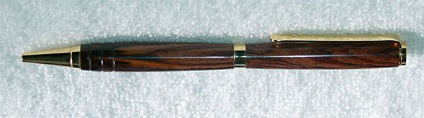

C Carole in VA Member Joined Dec 11, 2004 Messages 64 Location VA. Feb 5, 2005 #1 Turned the first pen from Mark's group purchase cocobolo. This was done from one of the blanks I had put in the "C" pile. Nice stuff! Thanks Mark!
tipusnr Member Joined May 15, 2004 Messages 1,692 Location Reynoldsburg, OH, USA. Feb 5, 2005 #2 Good work Carole. Wish I was there in person to get a better look at the grain!!
G Guest Guest Feb 5, 2005 #3 You gotta love the richness of that cocbolo. Good looking pen. What did you use for a finish?
T Tom McMillan Member Joined Jan 1, 2004 Messages 1,598 Location Washougal, WA, USA. Feb 5, 2005 #4 Very, very pretty Carole!!! Thanks for sharing!!
G Gary Member Joined Sep 10, 2004 Messages 1,371 Location Texas, USA. Feb 5, 2005 #5 Very nice, Carole. You did a great job!
D dougle40 Member Joined Nov 13, 2004 Messages 1,423 Location Essex, Ontario, Canada. Feb 5, 2005 #6 Great looking pen Carole . I love Cocobolo too.
J jwoodwright Member Joined Jun 4, 2004 Messages 2,270 Location Anchorage, Alaska, USA. Feb 5, 2005 #7 Great pen, love Cocobolo...[]
Deere41h Member Joined Dec 30, 2004 Messages 446 Location Denton, TX, USA. Feb 5, 2005 #8 Very nice looking pen. Cocobolo is such nice wood to work with and you have done it justice. Yes please share with us what you used for finish.
P PenWorks Member Joined Aug 18, 2004 Messages 5,186 Location Cave Creek Feb 5, 2005 #9 Very nice looking pen Carole, good job. Anthony
K KKingery Member Joined Nov 21, 2004 Messages 1,168 Location De Pere, Wisconsin, USA. Feb 5, 2005 #10 Very nice work Carole - very nice indeed!
C Carole in VA Member Joined Dec 11, 2004 Messages 64 Location VA. Feb 5, 2005 #11 Thanks guys. I used CA after the 220 sanding (without wiping the dust from the sanding) wet sanded the CA with 320 then went up through the grits to 12000 micro mesh, then Mylands Friction and a coat of Renaissance Wax.
