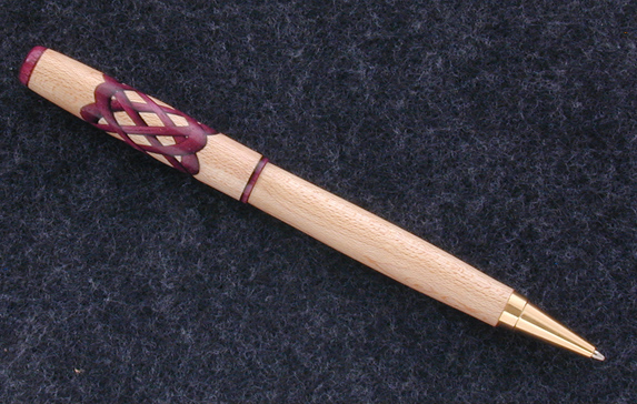

Truly unique. And the craftmanship is outstanding. Hard to describe the effect it had on me. Definately a high dollar item. I put the picture into a photo program to enlarge because I wanted to see that shadow, or shading, effect in more detail. Wow! [:0] Howdjadodat? [?][?] And the weaving effect is also very impressive. I like the natural elegance of maple. Believe that is a much overlooked wood by the bunch here. You mated it with a beautiful color contrast in the purpleheart. Mucho kudos.
Ron.....That is beautiful. I love the way it turned out. The two colors with the shading complement each other so well. Thanks for sharing it with us.
Wow! Thanks for all the compliments everyone.
Frank, maple has always been my favorite wood, this blank started out as birdeye maple, but every eye turned away. Bummer!
arjudy, sorry I don't have a photo of the blank before turning. I should start doing that.
I used an old tool I had hanging around the shop

Very nice work Ron.
I also like the shadow effect that you created and was surprised on how it was created.

You can also heat sand in a small pot and not have to be quite so careful. Dip and hold the edges into the sand for a few seconds and check progress.

That is the way I do it in marquetry. It didn't work well for this project.
In marquetry you are only tarnishing a small section and only an edge. On this I had to burn a flat side and the wood would curl by the time it was "black" enough, then crack when flattening out.

<br />Awesome pen Ron, did you have any bleeding of the PH on to the Maple?
No I didn't have any problems with bleeding. I was more concerned with the "burnt" wood staining the light maple then the purpleheart.
As soon as I was finished with the turning and before I started sanding, I used a 1# cut of super blonde dewaxed shellac and applied it as a friction polish. On coarser grits I applied this twice, once before and the second time in the middle of sanding. On the finer grits I just applied the shellac before sanding.

<br />how many sides your blank have 6 or 8?
This pen has six sides. The cigar pen has 8.
