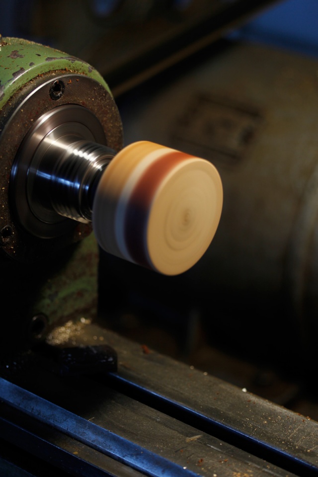

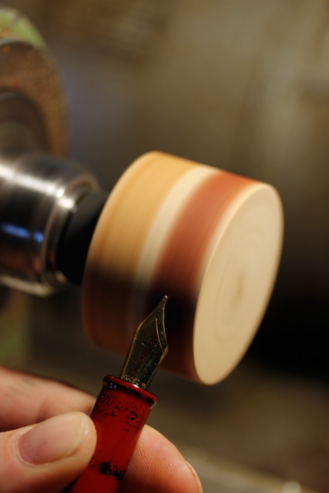

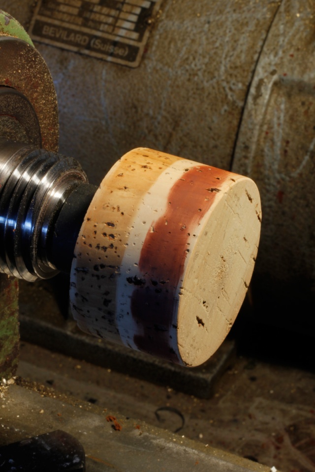

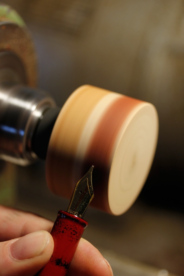

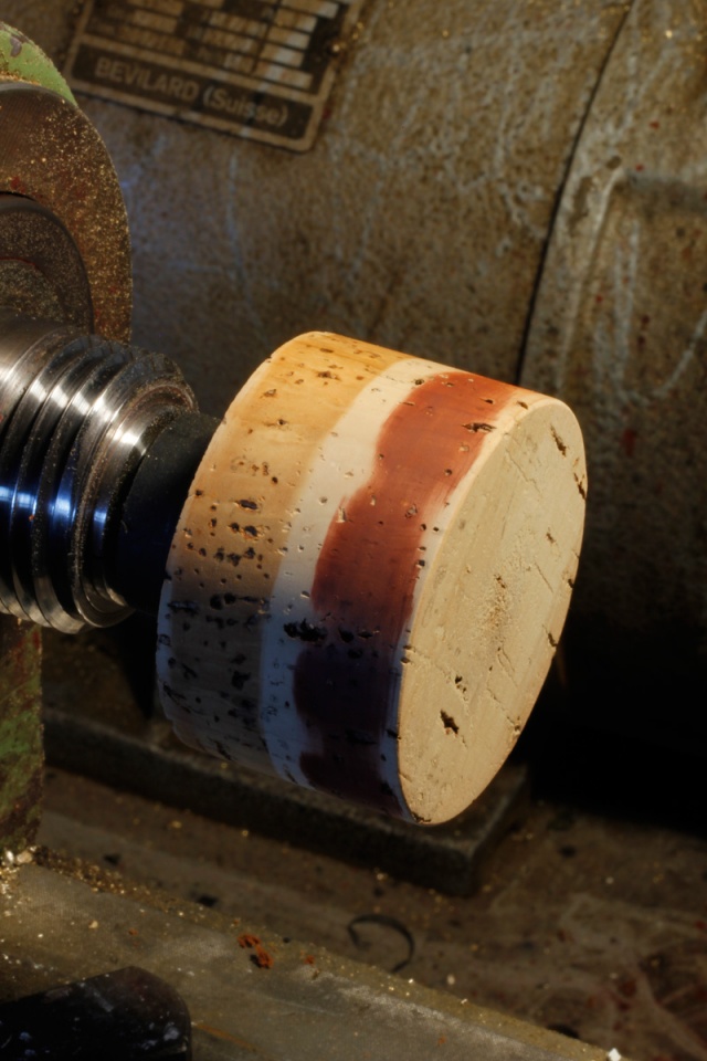

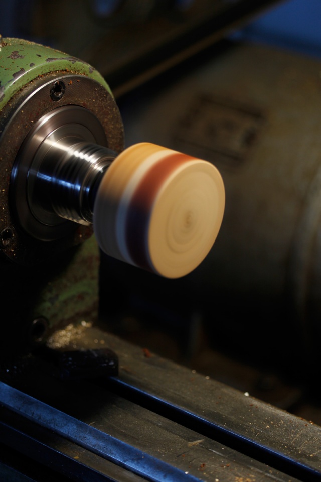

Just made a new cork disk for polishing pen nibs. Cork is a pefect base for pre-polishing metal. Many years ago when I was an active knife maker we always used cork for pre-polishing - especially - hollow ground blades.

I note from your Photographs, you show the Object being used on the Approach of the Rotating Cork Drum, and Not on the Departing or Under Side. Is this correct as I would have thought that it could be more than a little Dangerous, if your Angle of Approach was off?
I can see where it would be Excellent for getting into the Hollow Ground Face of Knives.

Brian, I can't tell if the pen nib is actually on the cork wheel or just being held in front. Also, perhaps Martin runs the lathe/cork drum in reverse.
