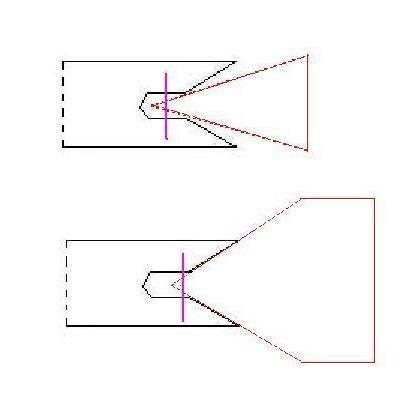

Unfortunately, what you propose is mechanically unsound and has caused a lot of people some grief. The tip that comes with the JET live center is a 30° point and is intended to be inserted into wood blanks. (unless JET has changed their tips recently) It "IS NOT" designed to be used with a center dimple in metallic stock. For a center dimple in metal, you need to use a 60° live center for best results!!
Below is a rough sketch that shows the fit of 30° and 60° tips in a center dimple and why a 60° is the preferred choice.
The upper drawing is the 30° tip and you can see that the bearing surface between the tip and the mandrel is very tiny. Because the bearing surface is so small the wear is concentrated and causes the tips to wear out prematurely. It is also possible that extra pressure will be needed to create enough friction to make the LC spin and this could lead to a bowed or bent mandrel.
In the lower drawing, you will notice that the angle of the 60° tip exactly matches the angle of the sides of the center dimple thus creating a much larger contact area. Less wear and more friction....that is the way the system was designed to function.
Sometimes, the center dimples are drilled with clearance holes that are too shallow. I have drawn a purple line to simulate where the bottom of the hole might be if it is to short. With a little imagination it is easy to envision that the extreme tip of the LC point would rest on the bottom of the clearance hole and there would be no contact between the dimple wall and the tip. This situation would totally defeat the purpose of the centering dimple as the tip would dance around on the bottom of the clearance hole and the wall of the dimple would provide no centering effect at all. Additionally, this would cause severe wear on the tip of the LC. As you might imagine, this possibility is more likely to occur with a 30° tip. If the clearance hole is too shallow, the easier solution for most folks is to file a bit off the end of the tip.
