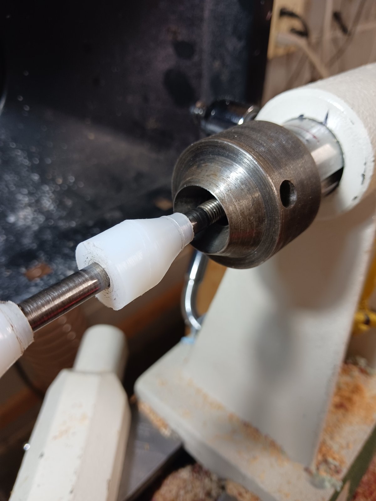

I have a live center and removed the point. It is hollow all the way through. I experimented this morning. A HDPE insert takes up the slack in the live center and the quill moves so it is adjustable for blank length. I turned the lathe so the headstock, mandrel and live center all rotate. So I saved $XXXX and look forward to turning with it real soon. Instead of the HDPE insert, I'm going to see if I can get one made of aluminum. Or find a bushing that fits the live center. Any suggestions are welcome as always.

Thanks, Dave. Have a source at a local machine shop. Just need to get the dimensions, live center mikes at 0.390. I'll take a photo later this morning and post here.
Here is the photo of the setup. I can either use a tapered insert or one that is machined to fit snug.

Back again with some good news. As I said, the opening in the live center mikes at 0.390. I checked my Woodcraft chart and found that the Princeton/Wallstreet series mikes at 0.381 which is what inserts into the brass tube. Snug fit; will try it on a pen blank later as I have other things to turn.
