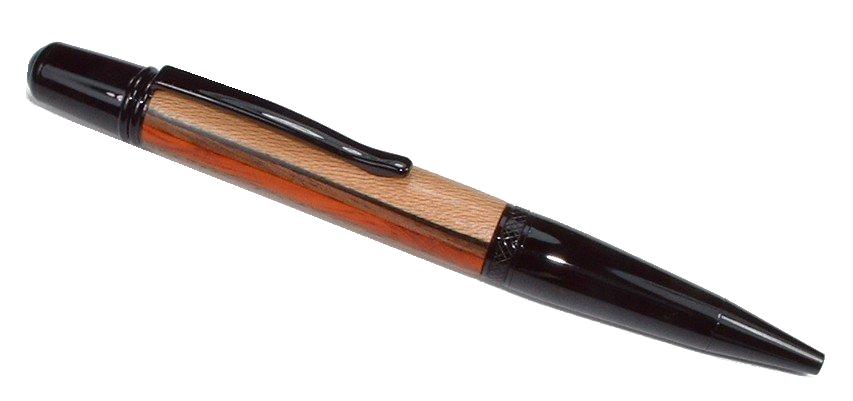

I was lucky enough to win a set up from John Goodin's (johnnycnc) holiday give away and had a chance to turn a Sierra today. This setup is really sweet! There's no mandrel -- you line up your blank and bushings between centers. It runs so true, you're hard pressed to tell the lathe is even running when you touch the bushings. I think it is quicker and easier, too.
The pen is nothing special, but it was especially fun to turn.

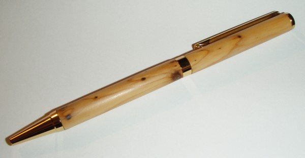

I turned up a pair of "bushings" from some soft steel rod on my lathe and they seem to do the job. Here's my very first pen, turned from Yew:
<br />
With thanks
Bernie
Exmouth, Devon, UK

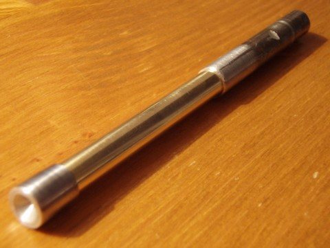

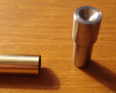

In case anyone is interested, here are some snaps I took of the tube holders I made from some cheap 8mm steel rod. Here you can see the tailstock end that was turned to fit over the live centre. The brass rod is lying down next to it.
<br />

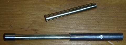

Here's the brass tube held at both ends by the turned steel rod:
<br />
And in this picture you can see the mark I filed on the headstock piece which I hold in my chuck jaws. The file mark is aligned with jaw number one to maintain consistency:
<br />
Happy turning!
Bernie
Bernie, that is one way to work it. The only "down side" is by holding it in your chuck, you can still have some run out from the chuck. This all depends on the lathe and chuck, but you have a good point on the notch.
One other point, what did you make the cener hole with? From here it does not quite look like a 60 degree hole, it appears "wider" to me. They make special "center point" drill bits that pilot the hole and then cut it to 60 degrees. This would show the center point cutting about a 1/8" hole in the center of the taper which I do not see. You may be just running on the tip of the live center in that hole which will wallow it out and start to slop if this is the case.
