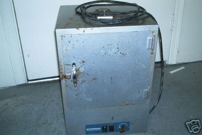

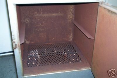

Mudder - Good point! I probably won't be able to inject steam, but if I put a small can full of water (like a juice can) in the oven, I think I could at least raise the humidity some. Maybe I could pipe a small electric tea kettle into the side of the oven to 'inject' some steam; just thinking out loud, as it were.
Loglugger Bob â€" Thanks for the temp reference (and in Fahrenheit even!!)
Here are a couple of pictures of what the oven looked like when I received it. I have since cleaned it up a little bit and fabricated a couple of metal shelves for it.
