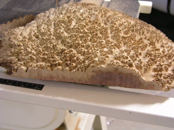

To be honest, I don' think either of those are Red or Brown Mallee Burl. The bark on remaining on them is incorrect for those two. At least in my experience. They are beautiful none the less. Mallee burl tends to have a very spiny and recognizeable bark. Here is a photo of a Red Mallee Burl that I cut up when making the desk set I posted here before. Notice the bark. I also have 4 more large burls arriving tomorrow. I will photograph them and show the difference between red and browm mallee.
Cheers,
Fangar
Every one has a point...but without seeing the wood up close we can't be certain.
While Fangar's example is correct, it is also true that not all burls (mallee included) will be as nice as he pictured. It is a fine example of a premium burl cap...but below and around the cap you may find something similar to Hank's picture above.
The weathered sides on Hank's pics make it even more difficult to ID.
I think you'll have to decide based on whether the wood is worth the price and go from there. Looks like good value from here though.
When I was in Australia they had several different types of mallee. As stated above there is red and brown but it is not that simple. Fangers example is red mallee burl as we know it but they also had mallee root which looks like Hanks pics.
As I understand it the mallee burl is a lignotuber, which is an outgrowth from the root. The root itself is not so figured.
