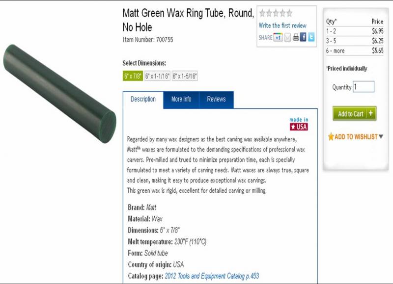

Start out with a wax cylinder. These should be jewelers wax and are available from jewelry supply houses, ebay, etc. I usually get mine from RioGrande. I think the smallest diameter they make is 7/8" so the first thing I do is turn it between centers to about 3/4" so it will fit in one of my collets. (Note: wax can be easily turned with any tools you use to make pens- nothing special needed) If you drill on a drill press, this is not necessary, but I like to drill on the lathe. They are 6" long and I usually cut them into pieces about 2" long, but any length will do.

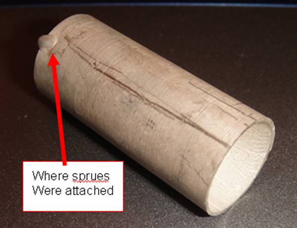

If you have scratches in the wax, you will have them in the silver. It is a very true reproduction method with a very small amount of shrinkage. The casting you will get back will have some small places of heavy silver where the sprues were attached, but these are easily filed off. The piece will also be covered with fire scale which too is easily filed or sanded off.
attachment.php
