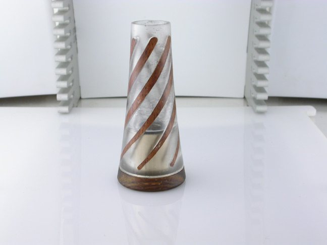

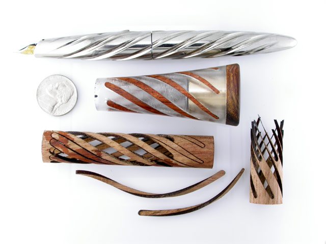

I made a prototype of the base of the pen I've been working on. I had to prove out the difficult programs needed to cut the spiraled grooves in what will be a titanium pen. The grooves are filled with wood. These are not just veneers, but they are relatively thick, and are laser cut in spiral forms to match the grooves so the grain will be continuous. The prototype has cherry and I intend to try olivewood for the real pen. I was originally going to make the entire pen shape from wood and then laser cut the spirals from that shape. It would work, but there were going to be manufacturing difficulties of making such a thin trumpet bell shape on the lathe. For one, the hydraulic tailstock of my lathe would crush the part. For another, this meant having an 8" long x 1 1/4" diameter wood piece that everything would be taken from. It is expensive and wasteful for the highly figured wood that I'll be looking for. I was able to get all the spirals and the spirals for the upper half of the pen (not made yet) from a single 3/4" x 3/4" block 3 1/4" long. The spirals all nest together so that the grain will match on the upper and lower parts. The base ring is now cocobolo, but again will be olivewood. There will be an upper ring as well. The pen will have the spiraled wood on the back portion and the front portion will have spiraled grooves. The upper wood ring will have internal splines that fit the grooves so that they act as threads. On the inside of the base is an O-ring that seals off the nib.
My progress has been slow because I've been unusually busy with the rings. Last month was a record month. The upper pen part has its share of challenges as well. One is that the nib end and the back end both have an angled cut. It was a challenge to figure out how to orient the darn things. Another was to be sure that when the pen is set down in the base that the grooves all line up. There's still fixturing and manufacturing stuff to figure out before I can make that part.
Just wanted to show that I am in fact working on pens when I can!:)

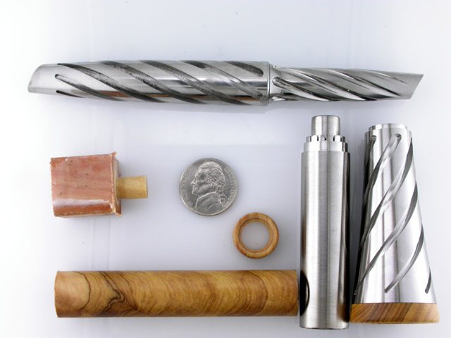

The picture shows the wood spirals. Some are still attached on the wood tube. As you can see, there's not much room between the spirals! The spirals still needed some careful persuasion to seat into the slots of the flared base, but I soaked them in oil to help soften them up. When they were glued in, they stuck out of the base, and I was able to put the part back in the lathe and kiss them back to flush. They were finished with CA and sanding from there.
So you decided to cut the spirals out of a cylinder rather than a trumpet? Or is the barrel you show for the pen body spirals?
I find the design of the base extremely attaractive!
Hi Rich. Yes, I tried to see if I could get both the long upper pen body spirals and the shorter pen base spirals out of a smaller diameter. The parts actually nest with one another with no room left over. Since it will be olivewood, it would save a lot on the wood cost. I wasn't sure if I could do it or not since the shape was not the same. It took a lot of trial cuts to get the wood to fit. I had to keep tweaking the shape. The other issue at hand with cutting them from the trumpet bell shape was that I would need to use a long and slender boring bar to get inside and the part would be fragile. It would also need a special fixture for the laser. Another technique I looked into has the wood drilled at different diameters on the inside. You can see the cut view of that in the CAD drawing. The issue with that is the wood spirals change thickness, so I was afraid that I would have to use more laser power and mess up the thinner sections.

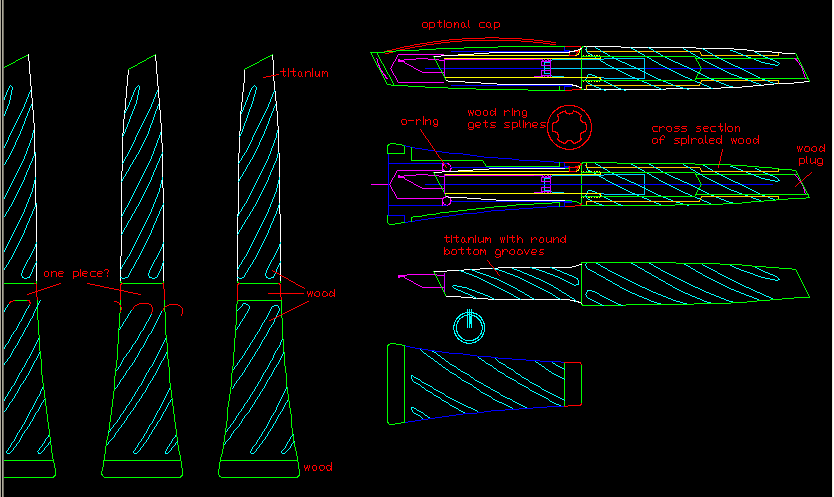

The wood would definitely fit better in the slots if it came from a trumpet bell shape, but it would add a lot of time, complexity, and cost to make it that way. As you can see on the CAD drawing, I toyed with the idea of making all the spirals and attached upper ring from one wickedly cut piece. It would have been a technical wonder, but didn't look to flow as well as the separate spiral pieces.
The base looks better in person than the photo allows. You can see all the internal glue spots and drill marks that won't be visible on the real part. The pen part will flow seamlessly from the base when it's in position, so I'm looking forward to trying that. Because the upper part is pretty thin, I might go ahead and try it in titanium the first time out. I need to make a tap for the nib and make a brass sleeve that it screws into so that it can be reoriented to match the angled cut at the front of the pen. The back part of the pen will then be made with an angled cut that needs to match the front part. Doh! [:0]

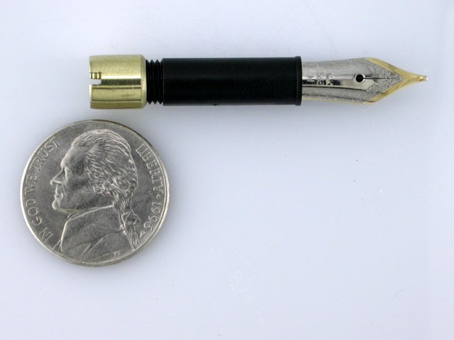

I rehashed the way to orient and hold in the nib last night. I came up with a much better solution than what I had in mind before. I'll made a small cylinder of brass that the nib screws into. In the front body of the pen the hole chokes down in size so the nib can't slip any further from the front. This new brass piece serves as a nut to hold it in. I'll make some screwdriver slots in it and make a special screwdriver tool that can tighten it down from the back while the nib is held in proper orientation from the front. This will allow for fine rotational orientation the splines or morse taper or other techniques I was considering had issues with and is a lot easier to implement. I'll try to make that tonight if I can get ahead of the ring orders.
<br />
Here is the brass nut that the nib assembly screws into. It's a tiny little thing. I had to make the M6.5 x .7 tap for the threads. The part is extremely thin so that the ink cartridge can plug into the nib without crashing into the brass walls near the screwdriver slots. I'll make a cylindrical screwdriver tool that can go in from the back side of the pen that's exactly the diameter of the tiny screwdriver slots. This will allow the nib to be rotationally oriented to match the angled cut on the front of the pen.

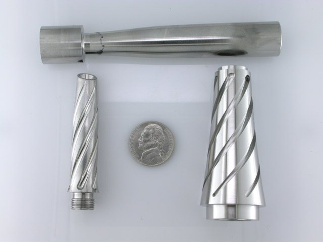

I have the 3 main parts turned in titanium. I literally worked all night long last night and all day today to get them to this point. I've run into a couple issues. Tapping the main body with an 11mm hand tap proved extremely difficult. I didn't do it on the lathe because it's not a high performance tap and I figured it would just snap right off. I can only get a few threads into the body. Titanium is darned near impossible to tap by hand. I can shorten the barrel threads a little bit to compensate. Being titanium, they'll still be plenty strong. My other issue is that my steel mandrel to mount the base onto the 4th axis machine has a .500" diameter. The hole drilled was also .500". It was a clean enough bore that I could press the part onto the mandrel for machining the spirals. A .501" ream should make it easier. The same story goes for the hole for the nib. It's so tight that I could use a ream that's a couple thousandths of an inch larger than the drill I have. I proofed both parts in aluminum first. I made a couple tweaks to ease up on the slot depth on the front barrel, but other than that, they looked to work well. I have something like 20 programs now.
Tonight I need to write the code for machining the spirals on the long back side. It's every bit as much of a chore as the flared base ones were. The part changes diameter while the spirals go around and get wider at the same time. I use a calculator and a CAD screen to calcluate all the hundreds of coordinates by hand. Did I mention that I also need to orient them to match the lower barrel!? Doh! I'm getting a little punchy.[|)] I need to go ahead and write the code before the ring orders flood again tomorrow night.
I still need to hash out the middle wood ring that has the insides splined. It will be tough to make because as it's designed, it needs turning from both sides as well as lasering for the splines. I won't be able to regrip on the wood for turning the backside without destroying it. I had a new idea that I'll persue for that after I write the code for the long barrel.
I finally got the coordinates done. It took a while to remember how I did the calculations for the base spirals. In the hundreds calculated I only missed two. I was able to run a toolpath simulation on the computer and two of the lines looked out of place. I'll run the part tomorrow. I need sleep!
Yesterday, I actually did drink a Coke around 7:00 pm because I knew I'd hack on it all night. I went to bed after the sun started coming up. [|)]
I got the spirals cut on the back barrel. I had to make the first cut on the aluminum prototype and see how the spirals lined up and adjusted the code accordingly. The spirals and the two ends match up well. What looks to be an angular difference in the picture is just from parallax from the tight shot. I turned the middle wood ring and the small plug that goes in the end from the remaining part of the pen blank that the spirals come from. I do both in one program. I just clamp the hydraulic chuck on the square wood, crushing it, and turn what sticks out of the chuck. I chose the nice looking turned blank in the pic as the final attempt wood. It looked best of the ones I did.

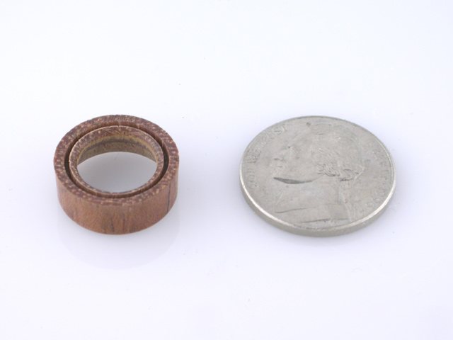

Here's the back of the middle ring with the trepanned slot to fit the boss on the pen base. The inside also has a radius. Both were done with the new tool I made.

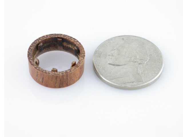

Here's the ring with lasered splines in them. Getting it to line up with the laser is tough, and some good fixturing will come in handy. Notice the splines extend downward a little from the upper ledge.

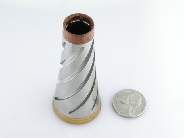

Here's the base with the middle ring in place. This prototype was made in cherry. After putting it in place, I kinda liked the contrast in woods between the bottom and middle rings. Hmm... I might keep it olivewood because there will be a plug in the upper barrel that will get laser engraved, so it will show up better on the lighter olivewood.
It took several tries to get the ring to work. They kept getting crushed as they came off the lathe, so I slowed the cutoff speed way down. I also added a stopping point where I add CA to the part then turn it back to flush. It fills all the pores and strengthens the wood. I still need to figure out how to best get the "laser tar" off of it and final sand the delicate splines. Maybe sandpaper on a toothpick or something. I'd like to get better consistancy there.
